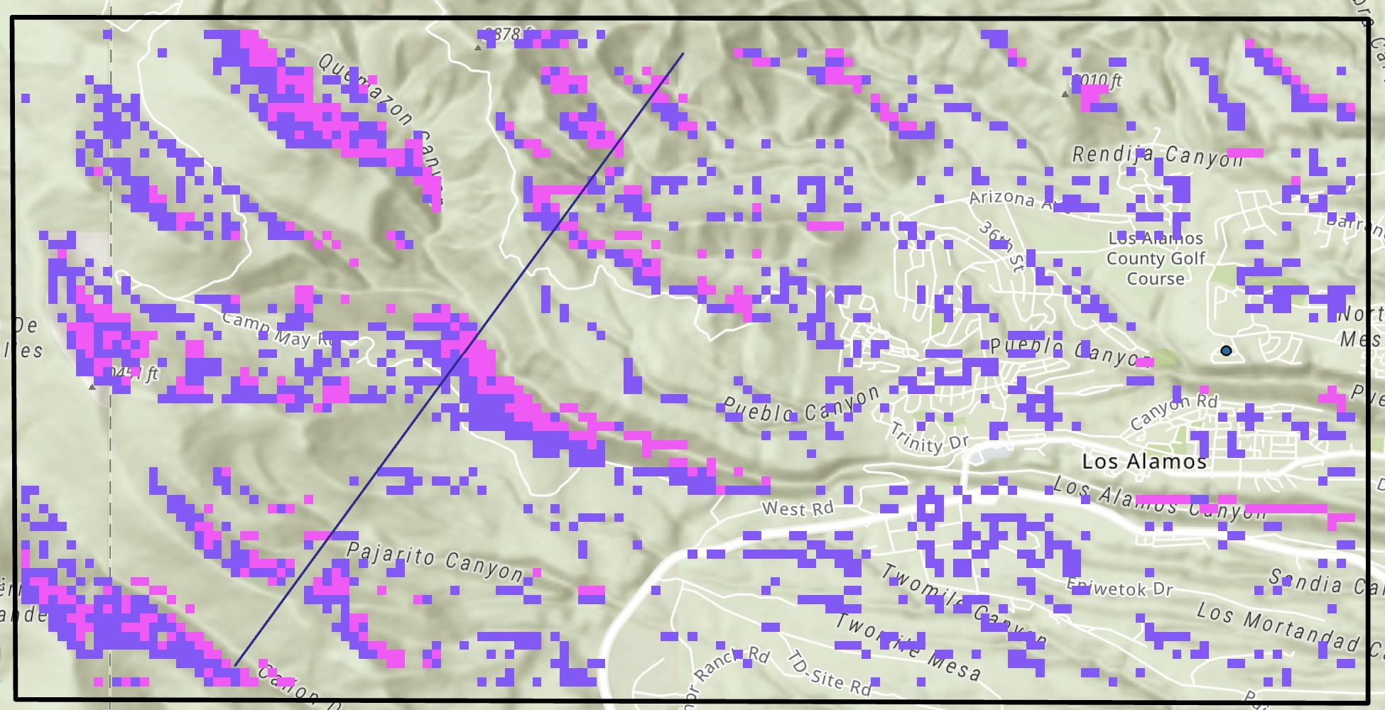

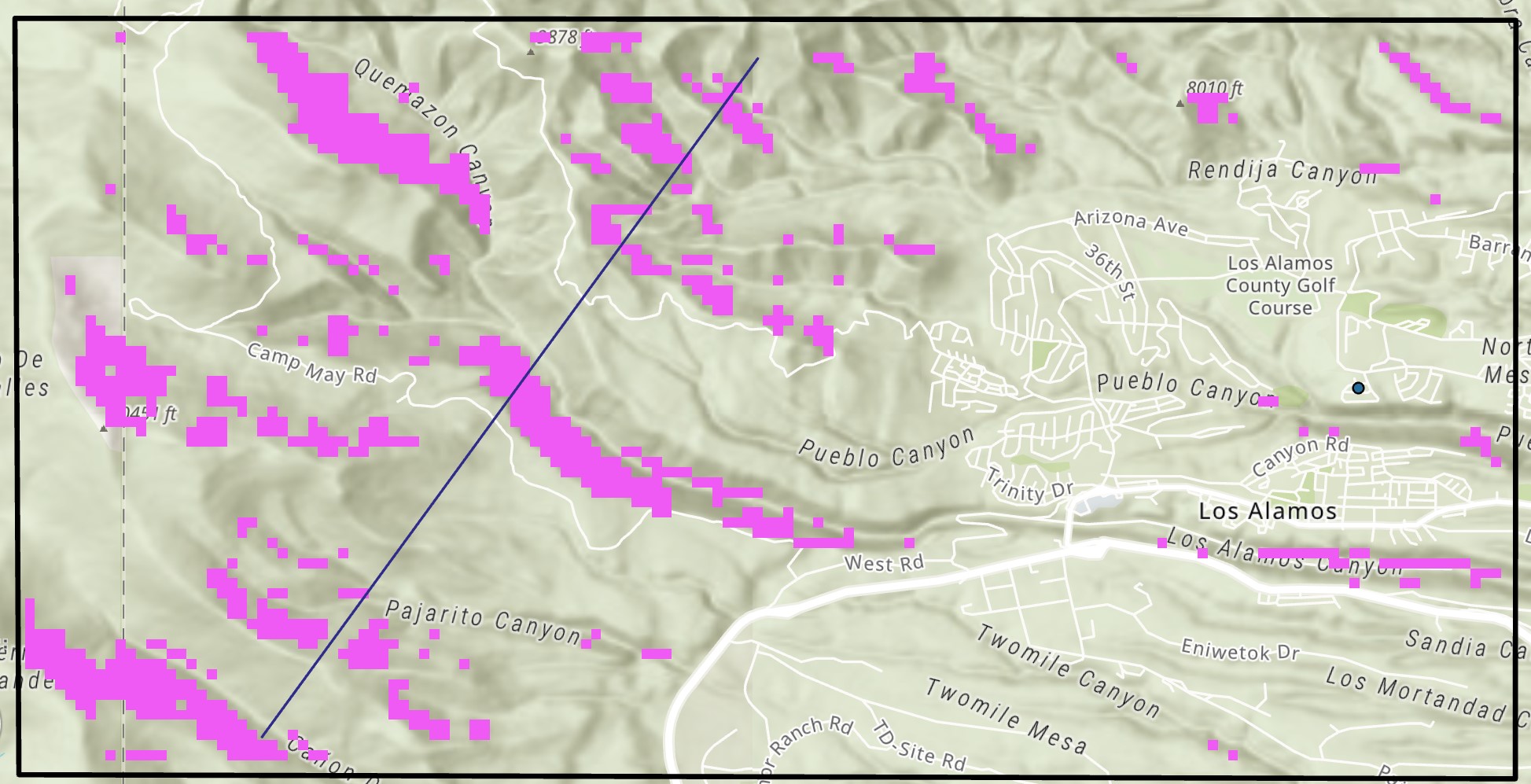

Hi,
Am new here so excuse me if my question is naive! I have a terrain-filter raster in pink and another raster filter in purple (shown overlying the first). I am only interested in the areas where the pink and purple are connected.  In other words, I want to remove all the purple areas that are not associated with (adjacent to or overlayed) the pink regions, leaving just the areas where the two filters touch.  I then want to merge them together to make a filter combining both (I do not need to separate the pink from the purple - I just want to identify regions where the two filters are connected.
How can I achieve this?Pink filterPink filter overlain by purple filter

RachelBadlan
Thanks! Have used the combine tool (below), but how do I remove the values of '3' (which represent areas of light purple) that are isolated? i.e. are not next to a '2' or a '4'? (See pic below for example of areas to remove and keep)
Thanks in advance!
