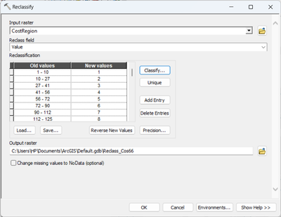

The reclassify tool takes the input values and changes them.
https://desktop.arcgis.com/en/arcmap/latest/tools/spatial-analyst-toolbox/reclassify.htm
In your screenshot you can change the entries for old/new values to what you desire. e.g. you could reclassify values:
  • 0-56 = 0
  • 56 - 137 = 1
The output would be a raster with two values, 0 or 1. A 0 values indicates that the cell value is under 56 and a 1 value indicates it is higher (with 137 just being the highest value of the input raster).
Having a 0 or a 1 value makes it easier to do further analysis. E.g. multicriteria analysis would exclude sites that don't meet the criteria - excluding 0 - but could also weight sites, like giving values of 2 for those with scores over 100.
Your 'result' image has 4 output values. So it doesn't look like they've changed the values. They've just removed the value ranges below 56.
A solution is in the geoprocessing tool, delete the entries 1-10, 10-27, 27-41, 41-56. This will give you a raster with four output range values above 56.
If this is exactly correct, had to say without the full procedure, but you should be able to navigate it now with the above understanding.

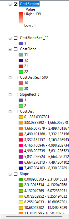

Steps 3 to 7 look like this. And Step 1 is creating a slope from DEM. Step 2 is creating a cost distance surface from the road and slope.
11 is the true value in step 5, right?
My layers look like this in TOC.
I feel like I'm doing things correctly but I can't get to the final result.

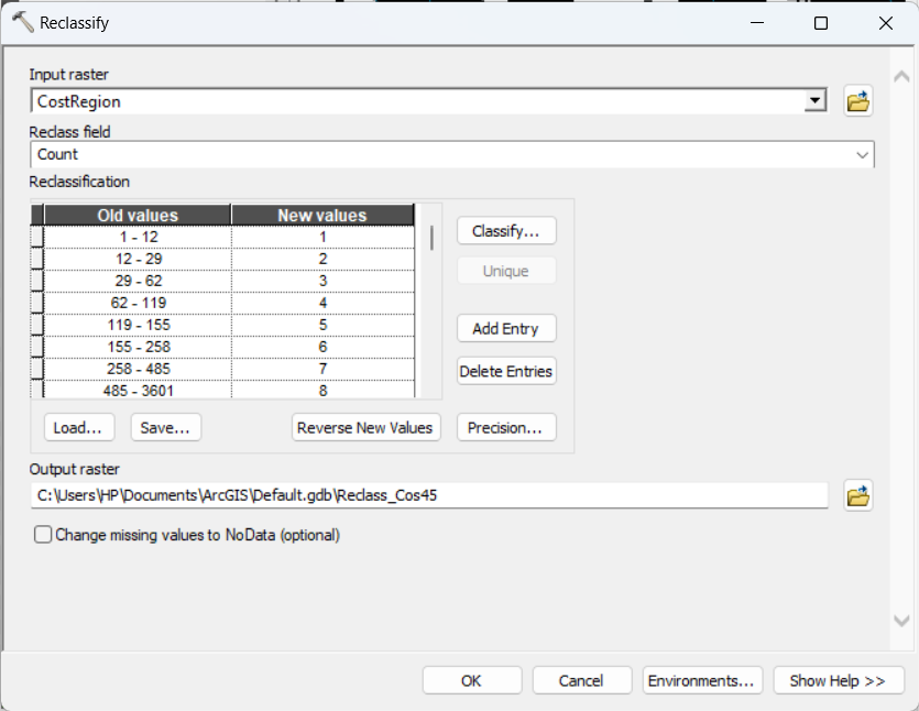

Screenshot 2024-01-28 182215.pngScreenshot 2024-01-28 182215.pngThis is what I was told.
Where should I put NoData in here?
