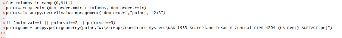

I am currently writing a python program that is scanning cells in a raster. If the program passes an if statement then I want to put a point file at that exact xy location it scanned. What is the function that inserts a shapefile at a specific xy location?

You would need to create the geometry first, then the featureclass or shapefile.  Start by examining the arcpy functions etc and specifically the code example in the PointGeometry class linked here

what is the function that converts the point geometry into a feature class?
DanPatterson_Retired
MVP Emeritus
the last line int he link I posted
arcpy.CopyFeatures_management(pointGeometryList, "c:/geometry/a.gdb/points")
