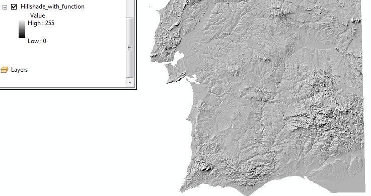

But used a Z factor = 5.
The result in arcmap is very nice:

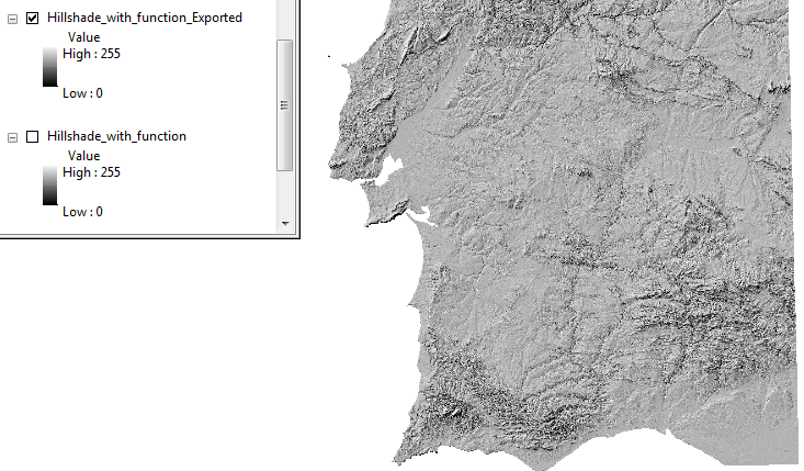

First attempt: Data Export, like it says in the Help. This is the result:
As you can see there's plenty more "noise"...

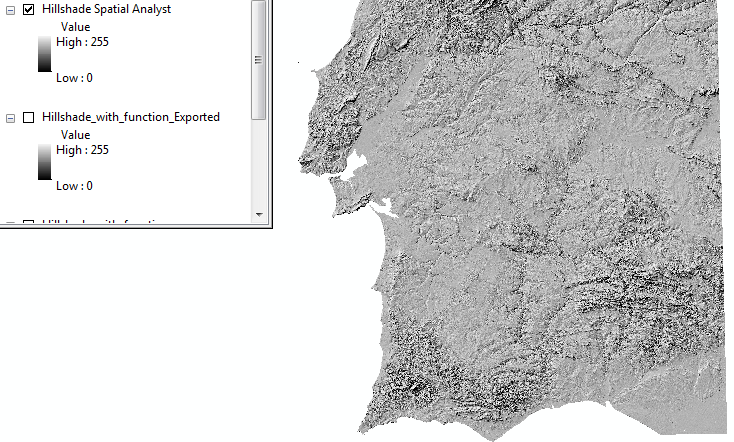

Second attempt: run Spatial Analyst Hillshade tool with the same arguments... I get the same noisy result:
... geonet applies some kind of aliasing to the images posted. In my arcmap these images are even more grained.
