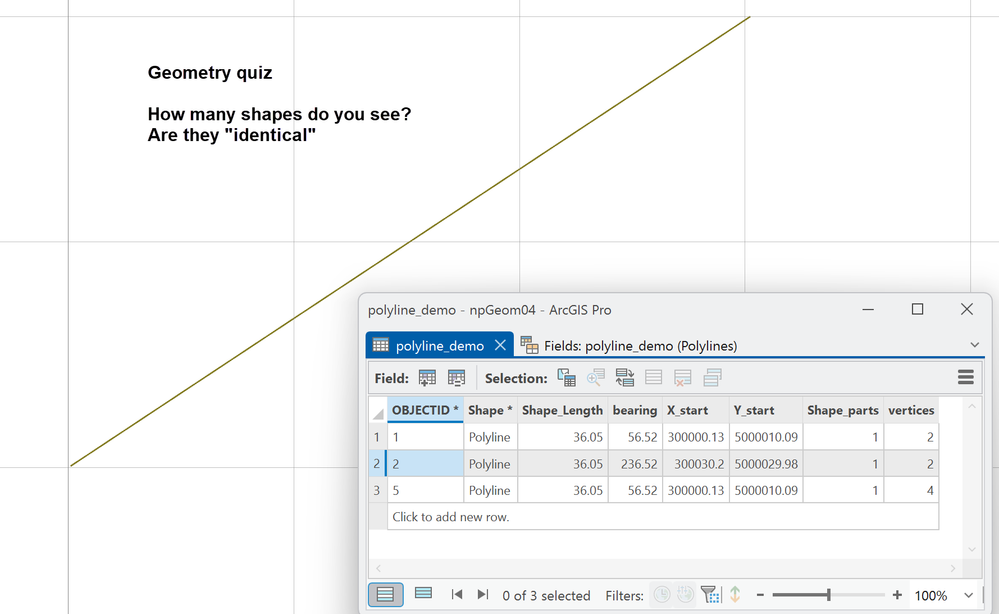

my reading is that Find Identical compares the points that make up the shape to ensure that they are coincident and in the same order.  There is no indication that they use other geometry geometry parameters such as length (or area, or volume for instance).
So using the Shape field isn't what I was referring to but the shape_length field.  This may undoubtedly identify seemingly identical features whose lengths are the same but their shapes are not.
To this one could calculate a shape extent, area field which in conjunction would further delineate candidates.
What am I gettin at?  consider 2 polylines that completely overlap.  The first is just 2 points, the second is a densified version of the first (that is, many points).  Therefore, only the start and end points are identical so you can use a point comparison to deem those as identical-ish,.  They do share the same areal extent, slope, perhaps orientation, definitely length, but they are only "identical" in one sense of the word but differ greatly in other contexts

DanPatterson
MVP Esteemed Contributor
they look identical but they are different in so many ways
