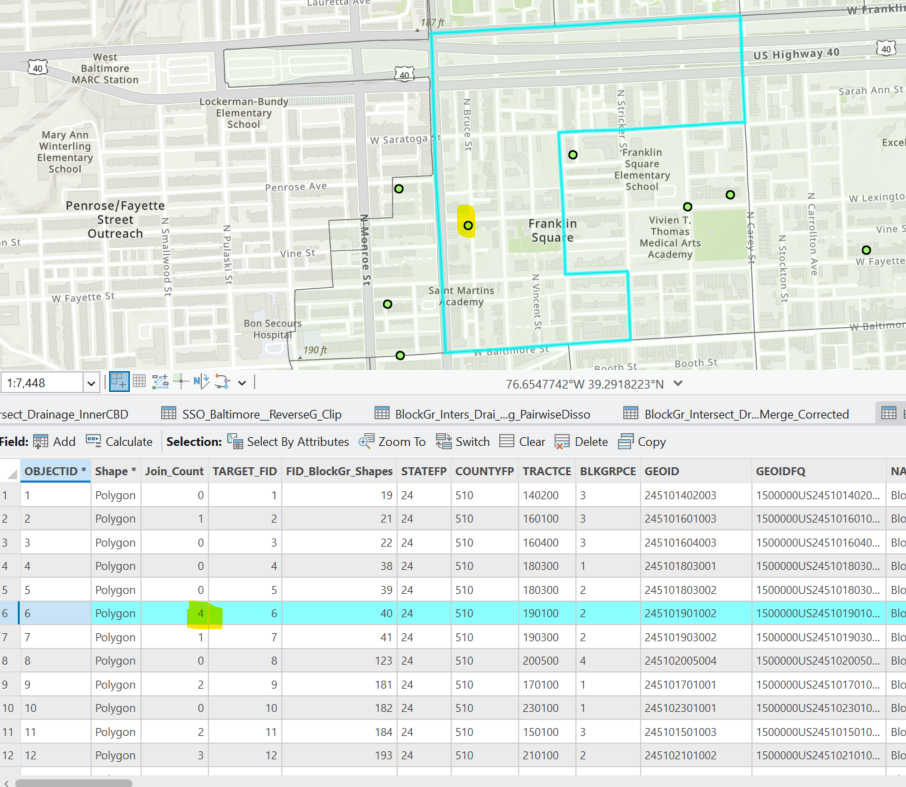

Now, I attempted a Spatial Join (Analysis tool) to count how many event points fall within each polygon fragment. However, when verifying the results, the Join_Count values are incorrect. Some polygons contain only one point when viewed on the map, yet the Spatial Join reports multiple events. The event data are simple points, and the drainage zones are boundary polygons, so I expected a straightforward point-in-polygon assignment.
Has anyone experienced similar issues where Spatial Join produces inflated point counts? Any guidance on how to correctly assign point data to subdivided polygons would be greatly appreciated before I proceed with the modeling portion.

I have seen this a few times, mostly it's because either what Dan said is going on, where a multi-part polygon is to fault, or the census block is larger than it appears, and may stretch underneath another polygon.
If you were to do this manually and inspect each point that is selected, is there any similarities between them that they would be linked to? I would see if it's points in a close range, or points randomly around, possible send over some screenshots as well if possible!

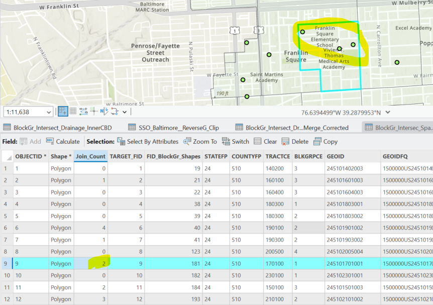

Can you symbolize the polygons with a fill, it is hard to tell from just outlines whether the polygons overlap.  I would run
Multipart To Singlepart (Data Management)—ArcGIS Pro | Documentation
to ensure that they are singlepart shapes.
Also polygon 6 does indeed have 4 points in it, but the only way polygon 9 has 2 points in it is if there are duplicate/overlapping points (so example the point table) or the geometry overlaps between polygon 6 and 9

Have you checked whether your point class contains any overlapping points? Maybe select one of the points in a "problem area", then open point attribute table to see how many points were selected.
Something else to try would be running the polygon layer through the Repair Geometry tool to repair any errors in the layer that may be impacting the analysis.
