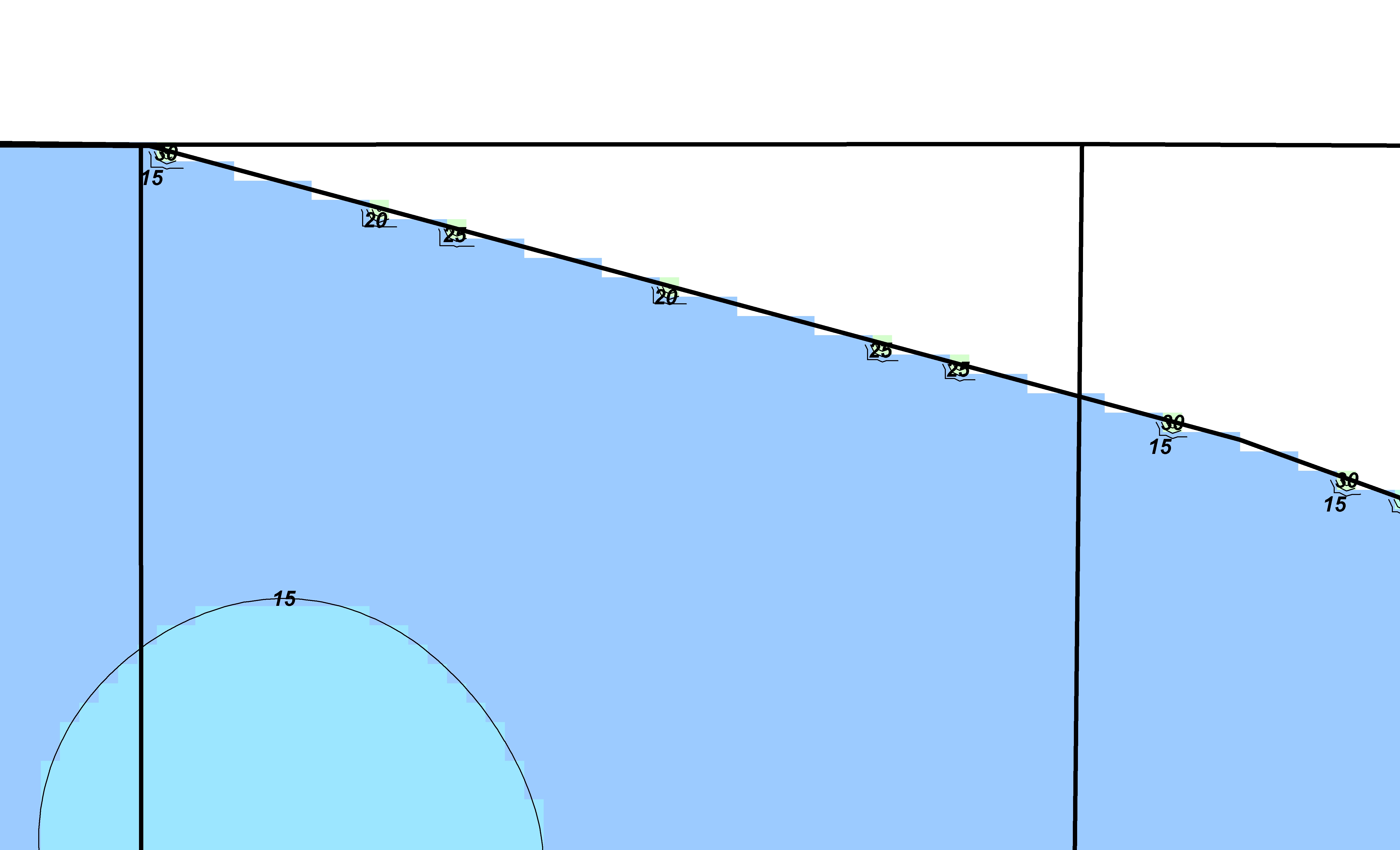

Is there a tool that will eliminate these "Artifacts" along the edge of a grid? I used "spline by barrier" to generate the grid then I had to clip the grid to get rid of the "No Data". These cells are left over and when I contour it adds these small clusters which wreaks havoc on my labeling!
Is there a better tool for gridding continuous numerical data? Should i decrease my cell size? (current is 200m).
Only way i can think of is to select each "Artifact" from the table of the contour layer and delete them. This is extremely time consuming on over 50 grids, so any help would be much appreciated!

Hi Daniel, you are going to have to run one of the genearalizaion tools after creating your linework.  Once you have an acceptable result your labelling should be fine.  As far as your grid cell sizes are concerned, you need to consider things such as your minimum mapping unit and extent.

If you are referring to jagged appearance along the edges...they are the grid cells ... they will never go away, you can decrease cell size to make them less noticeable but they aren't artifacts they represent the nature of raster data.  For visualization purposes, you can mitigate the "jaggies" by decreasing cell size or convert raster to vector...where possible...

I appreciate your answers, I used the dissolve tool on the contours and that solved the labeling problem.
As for the grid cells, I think by using "Spline by Barrier" it created those cells along the barrier. It is meant for lines inside the data and not as a "clipping" tool. I think that's the problem. I am going to use natural neighbor and then clip the raster to see if those same zig zags disappear.
Both your answers are correct and helped! But i can only mark one as "Correct". I guess my next question is when you have continuous numeric data such as Sub Surface values for a formation in a well...essentially the surface elevation - measured depth, what is the best gridding algorithm to use?
I'm tying to contstruct a "Smooth" surface below the surface of the earth. The topo tools don't work since they use the Hydrology tools, or use flow to construct valleys...

Hi Daniel, as Dan says the grid structure producing the stair-step will never 'disappear'.  It is part of the raster structure. Natural Neighbor, bi-linear, etc will not make a difference. If you are looking into making a smooth surface of any type, I would look into the exact interpolaters such as an IDW or one of the local of global polynomial tools available in the geostatistical analyst tools.  Kriging may be appropriate if your data meet normalization criteria. Keep in mind all work on grids, so you will have to export to vector and smooth where (as Dan says) possible and/or appropriate--
