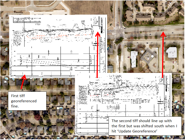

I recently upgraded to 10.5 from 10.2.1. Everything was going fine until I tried to georeference. Everything would be fine until I hit 'Update Georeference' at which point the tiff would move to a different location. Usually it would just be scooted down, but every now and then it would be moved off into no man's land. I researched trying to find out what the issue might be but couldn't come up with anything.
This morning I upgraded to 10.6 hoping that maybe it was just a weird quirk in 10.5 but the same thing happened in 10.6. I was able to georeference one tiff just fine, but the second one was shifted south as soon as I hit 'Update Georeferencing'. Has anyone experienced this and know how to fix it? Georeferencing is a large part of my job and I really need this issue fixed.

My group has been experiencing the same issue and can't seem to figure it out. We recently upgraded from 10.5.1 to 10.6.1 hoping that the issue was resolved, but it hasn't changed. So far the only work around we've found is to use JPGs instead of TIFFs, which is not always ideal for certain workflows.

I also have this problem that appeared when we upgraded from ArcMap 10.3 to 10.6. I too am trying to georeference .tiffs derived from .pdf. The georeference seems to shift to the south or southwest hundreds of feet when I hit the 'update georeferencing' button. I too have thought about the coordinate system but see no issue. I have deleted the Normal.mxt and recovered normal operation for one or two georeferences before it reverts back to the undesirable behavior. Fortunately, the shift so far is linear: meaning I can drag the image back to where it belongs and 'update georeferencing' again, and it sticks. Others might try ArcPro, which might save the georeferencing and translate back to ArcMap. I did not try a .jpeg.
