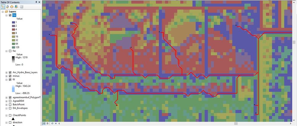

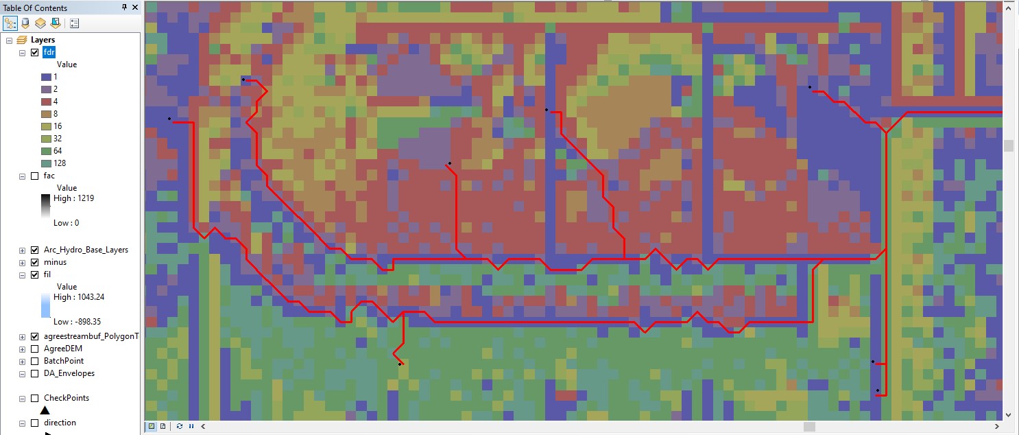

The first image shows the fdr grid and some flow path tracing lines. These are correct event thought the value of the fdr grid is -128. This may not be an issue, but all the examples have 128 instead of -128. I have deleted and repeated the creation of the fdr grid using SA and Arc Hydro tools.

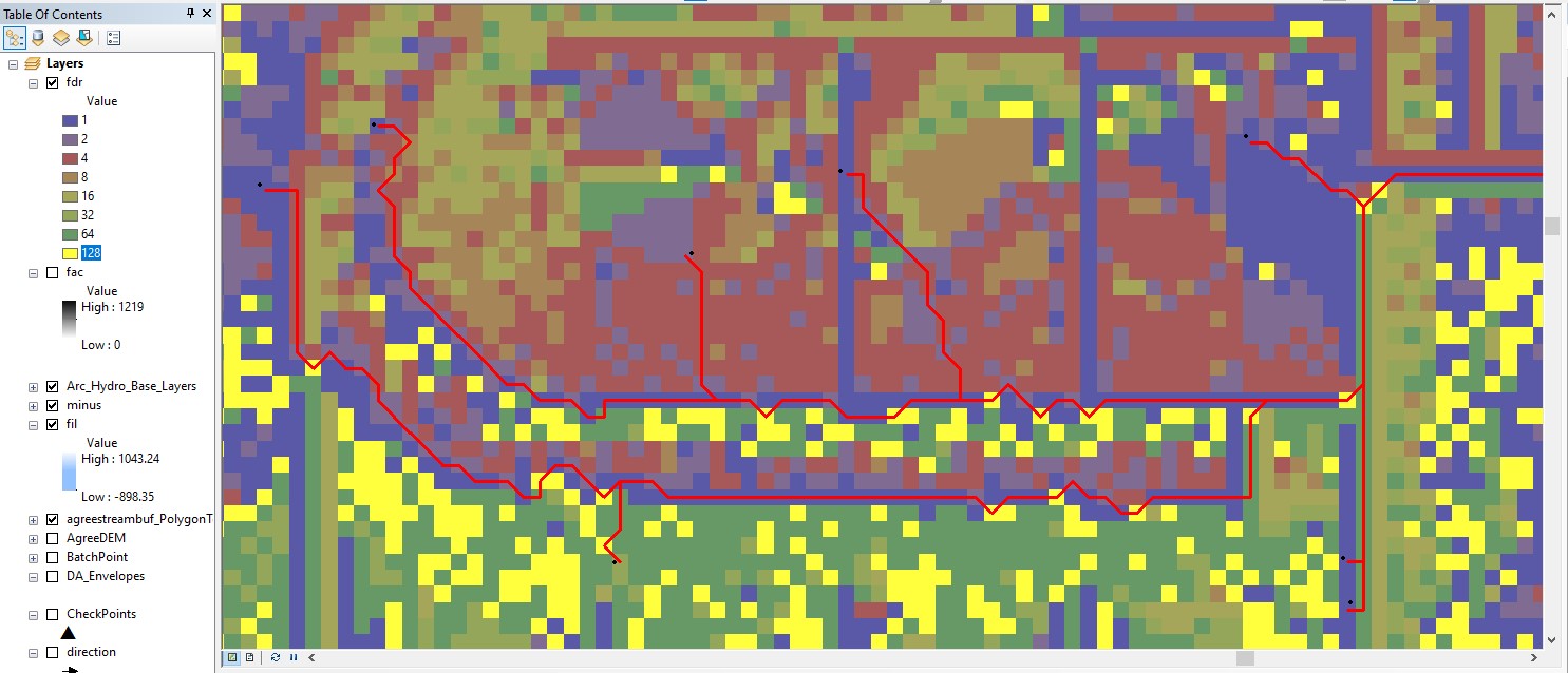

In the second image, I show the fdr with the 128 valued cells in yellow to highlight them. They are 128 in the table of contents, but using the i tool they show as -128.

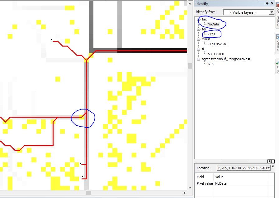

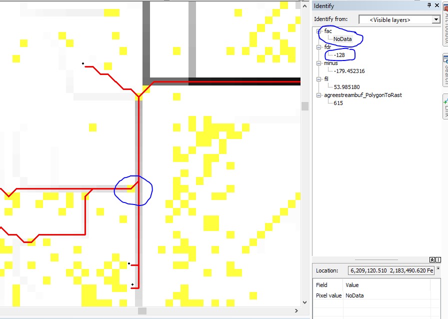

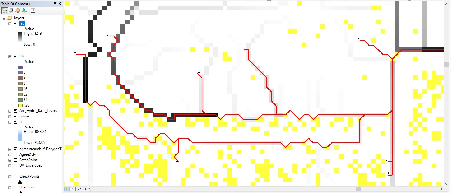

In the third image, I show the flow accumulation grid (fac) turned on over the fdr grid. You see the yellow cells “showing through” b/c the fac grid shows NoData. When this happens the flow accumulation starts over. It should continue and the cells should get darker along the flow direction (having higher and higher accumulation).
The forth image is a portion of the third image  showing the identify tool results on the right and the yellow cell that was selected circled with a blue line as well as the results circled on the right.

First Image - fdr grid and some flow path tracing lines.
Second Image - fdr with the 128 valued cells in yellow to highlight them.
Third Image - fac turned on over the fdr grid. Yellow 128 direction grids from fdr show through where fac is NoData.
Fourth Image - portion of third image showing results of the identify tool click on circled grid cell.
