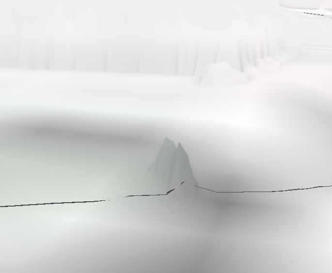

I have a high resolution DEM scanned from mobile LiDAR.  From this I need to create 3D curbs.  The problem is, where the curbs are, there are peaks of data (Could have been a small bush, car, bug)  After some research, the Fill tool seemed to be the most promising.  I ran it, but my DEM never seemed to change:
Orginal DEM:
Orginal DEM

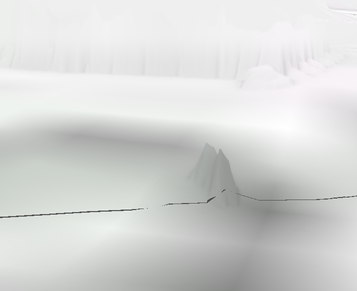

After running Fill:
Fill Spike
As you can see they are pretty much identical.  I ran the Fill tool with Z values left blank, and with Z values filled it.  Both ways kept the data the same.  The Filled DEM and the Original both have the same elevation.
Am I running the tool wrong?  What would be the best way to remove the peaks and smooth out the DEM?

Fill, fills depressions, it doesn't remove peaks unless you invert the dem
Fill—Help | ArcGIS Desktop
To get rid of your sample peak would probably require several runs of a Focal Mean or Focal Minimum

Scott, your peak isn't a spurious cell of elevated elevation, it has a pretty substantial areal coverage so it wouldn't be a sudden change in the localized trend
How Fill works—Help | ArcGIS Desktop
