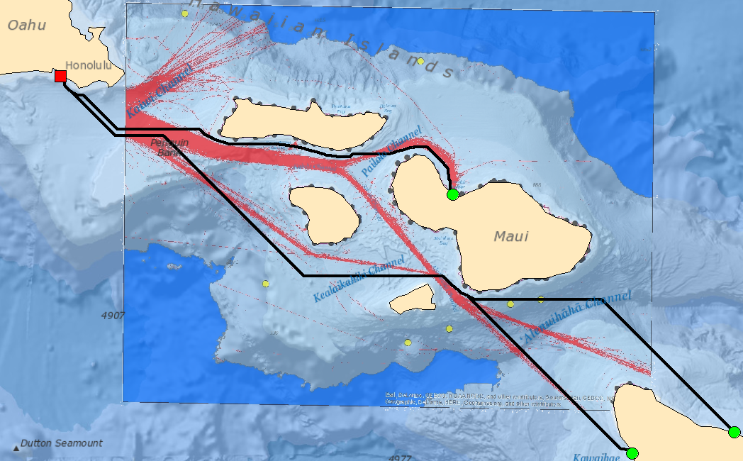

Edit: an image has been added for reference.  I am trying to find, among other things, the closest distance between the black points on the coastlines and the red polygon (shipping data), the blue polygon (depth contour), and the yellow points without crossing the islands in the center to measure said distances.

Indeed, as Dan already mentioned, you basically describe the process already suggested by Dan.

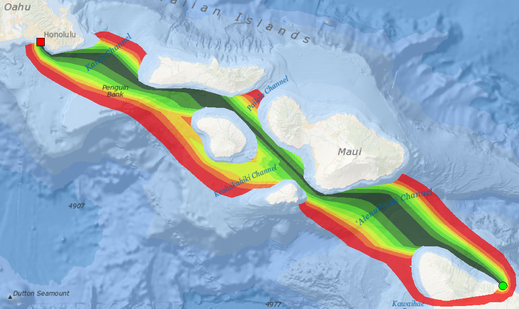

However, even if you define the area which is not navigable, your result will not be the same as the image you provided. There are probably more factors that influence the actual route a ship will take:
You can sum the cost distances from start to end and from end to end to get something like a range or zone that is most likely to contain the route:
In this case I varied the cost based on distance from the cost to get a little more variation...
