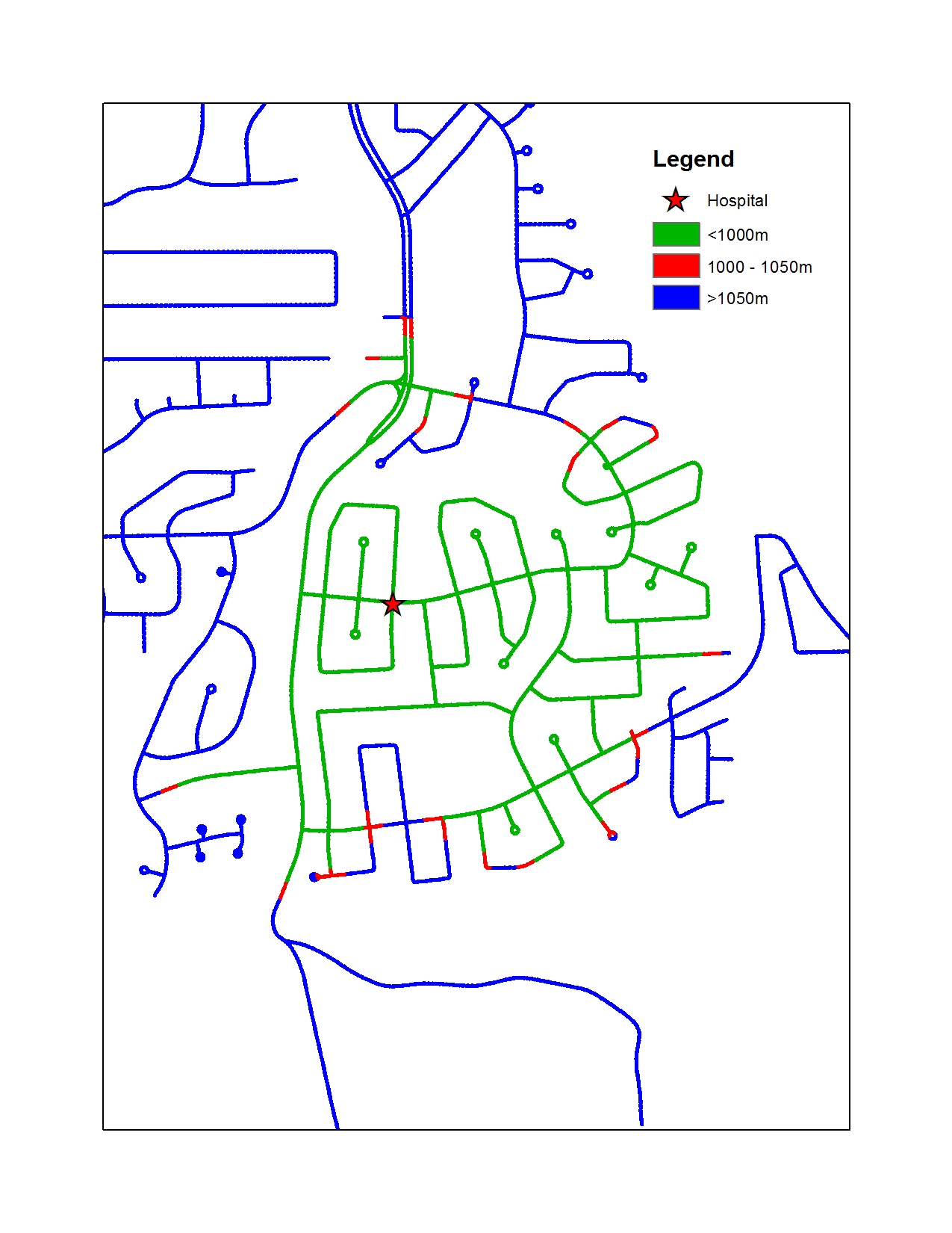

DarrenWiens2
MVP Alum
Example using Cost Distance:
