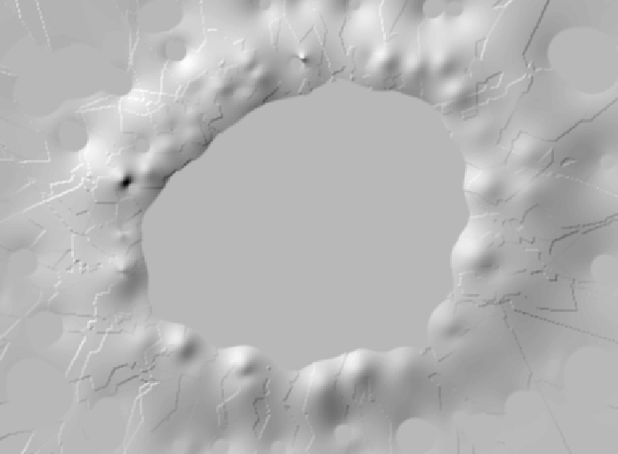

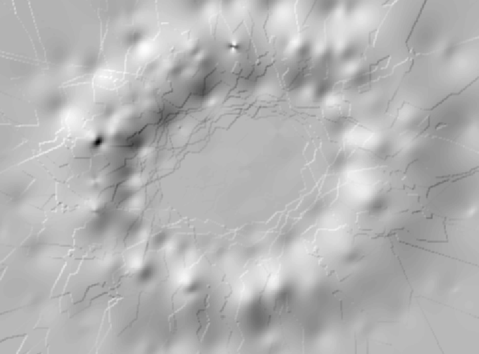

I am actually working on a project similar to this in respect to the needing to query the lowest "high" point on a ring levee.
Was this post ever solved?
DarrenWiens2
MVP Alum
You should be able to get to this using the Fill tool.
Hillshade Before:
Hillshade After Fill:
The values inside the filled sink are the elevation of the lowest point of the levee.

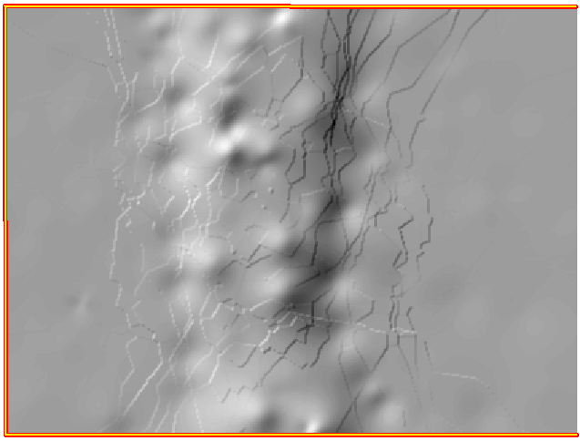

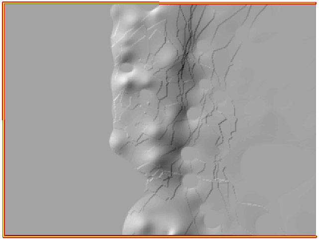

Similarly, for the original poster, Fill can do the job with an extra step of creating a bathub boundary around the raster and artificially altering the original DEM using the Con tool:
Before Fill tool (ocean on right):
After Fill tool:
Values behind the barrier are the lowest crossing point on the barrier.
