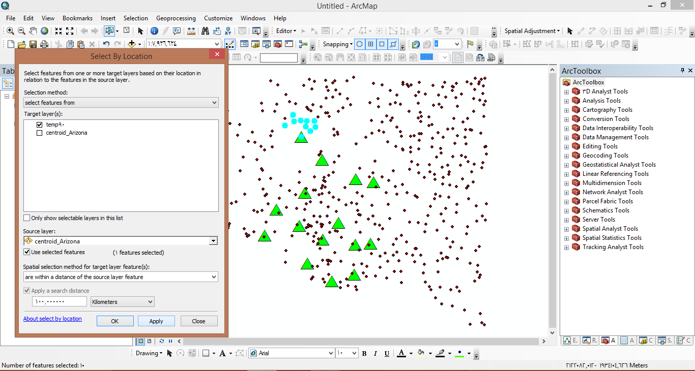

First select  by location for temp90 that with in a distance 100 km for any Arizona centroid as the following picture:

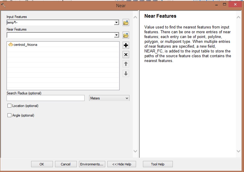

Then, calculate a distance for a round points using Near tool as the following picture:

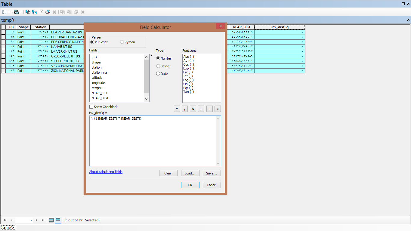

Now, add field (Double) and calculate the square of the inverse distance as you and Dan agree
1 /( distance * distance )
and it will be so small number close to zero , so ArcGIS write it in the field as zero
look for the picture:
so it is so logical that if you multiply Zero for Temperature value will equal zero too.
