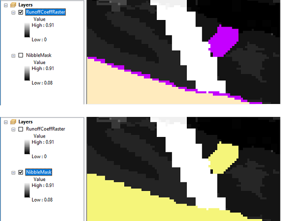

Have a look at the following. The first image shows the input raster and the input mask raster.
Note that I symbolized them a bit.  In the Runoff input, I symbolized the cells of value 0 with purple, and the NoData cells with a light tan colour.  In the Mask input, I symbolized the NoData cells to a light yellow colour.

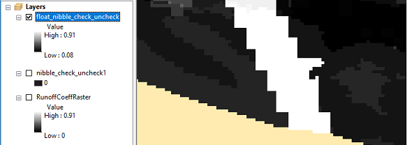

The next output shows the results.  The "nibble_check_uncheck1" entry (not activated) is the output from the Nibble tool. It demonstrates the problem you report, where it looks like the output is all empty cells.  The other result, "float_nibble_check_uncheck", is the outcome from running the Float tool on the output from the Nibble tool.  The you should be able to see that the cells that you were looking to replace (the purple value = 0 cells from the input) have been.
This workaround seems to resolve the issue for the time being.  I will take a closer look at the rendering problem, and will submit a software bug report accordingly. In the mean time, I hope that the workaround suggested will allow you to continue.
