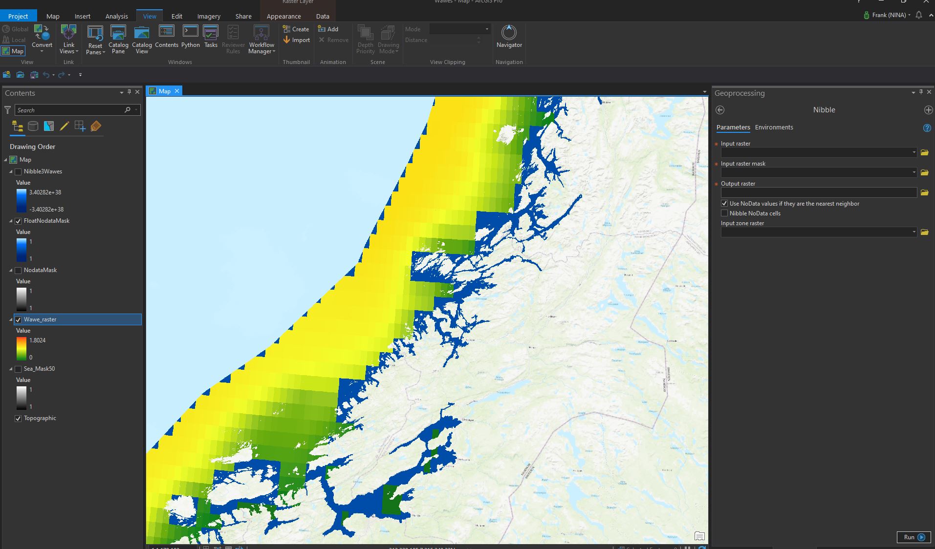

I have a wawe intensity raster with gaps (NoData), and I want to Nibble the NoData pixels from neighbouring pixel values (wawe intensity values) in ArcGIS Pro, using a separate sea water mask covering the NoData areas (pixels in dark blue). The two raster are 32 bits floating point rasters and have identical raster statistics, extents and projection. In addition all the required env. variables seems to be correctly defined. The Nibble tools performs well without any error messages. BUT the output is a raster with values from -3.4 to +3.4. The same problem occurs when I use the Focal Statistics tool... same problems with integer rasters, Nibble output 0-255. The floating output raster has the same size 2.8 GB, so there are some data in there.. I have also built new pyramids and calculated raster statistics without any improvements..
Any ideas why this is so, and how to solve this problem?

  1. First I converted all NoData wawe-pixels to 0 to allow the Nibble tool too do the interpolation (within the coastal zone area).
  2. I then used this converted layer as the input raster to the Nibble-tool.
  3. The original wawe-raster (with its NoData pixels) aim as the input raster mask. The Nibble output gave me the intended result, as visualized in the enclosed images.

Frank, it might be useful to show the input rasters.  I presume that you have a basemap on and it doesn't represent the landmass exactly
FrankHanssen

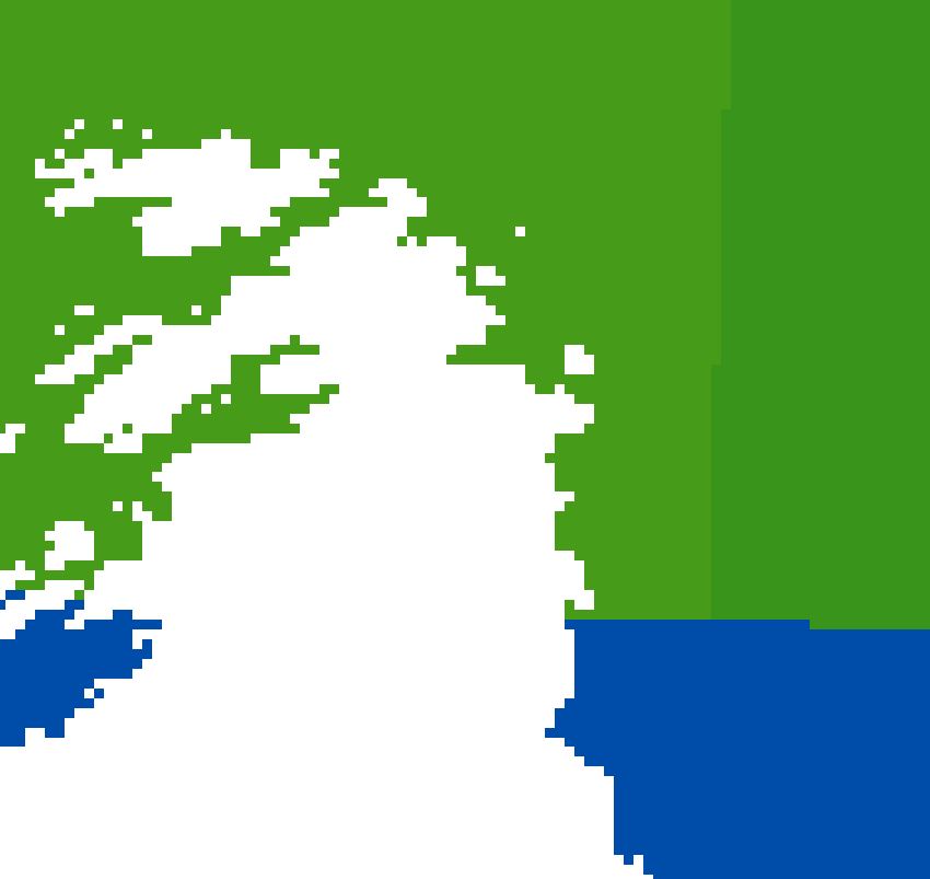

The input rasters are shown in the image above, Wawe intensity (green to red) and the NoData Mask (dark blue) Alle the data is within the coastal area region of interest.

The reason I asked is that the nodata mask (dark blue) appears to be at a much finer resolution that the other raster.  I guess I was hoping for a zoomed in location to see what was going on

They both have the same spatial resolution 50 x 50 meters (land pixels in white)
