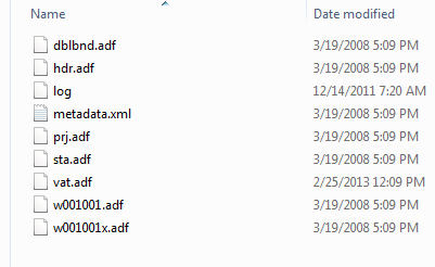

I would check if there is also an 'info' folder within the same directory.  Also, check to see if there are ADF files in the folder.  The info folder and ADF files are associated with an ESRI GRID.  Below is an example of the ADF files:
VictorKlinkenberg
Jake, you are wonderful! There were several ADF files in the folder, removing them solved the issue!
