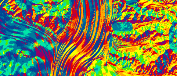

Profile curvature computed on a 5 meter resolution digital surface model (DSM) with the left image using a 3 x 3 (15m), in the middle a 9 x 9 (45m), and on the right a 15 x 15 (75m) window. With larger neighborhood distance the most significant or primary features of the landscape become more clear, the noise and striping artifacts are less visible.Profile curvature computed on a 5 meter resolution digital surface model (DSM) with the left image using a 3 x 3 (15m), in the middle a 9 x 9 (45m), and on the right a 15 x 15 (75m) window. With larger neighborhood distance the most significant or primary features of the landscape become more clear, the noise and striping artifacts are less visible.
Higher resolution elevation data often contain some undesirable artifacts (errors) as a remnant of the source data collection or processing as illustrated in the graphic above. Using an extended neighborhood helps to minimize the impact of these artifacts. The quadratic surface fitting described below also helps to minimize the impact of such artifacts.

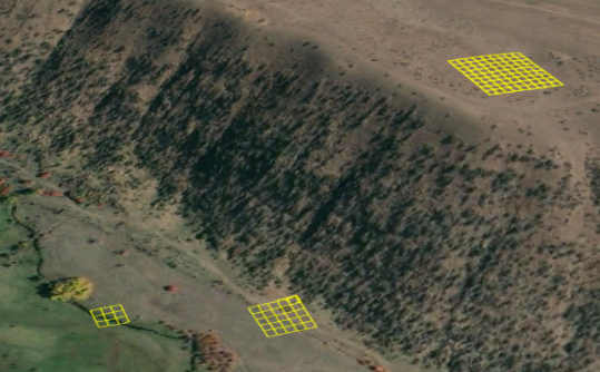

There is also an Adaptive Neighborhood option which evaluates the local variability of the terrain and chooses the largest appropriate neighborhood size for each cell. This can be particularly useful with gradual homogenous terrain interrupted by streams, roads, or sharp breaks in slope.
Simulated adaptive window size over varying terrain.Simulated adaptive window size over varying terrain.

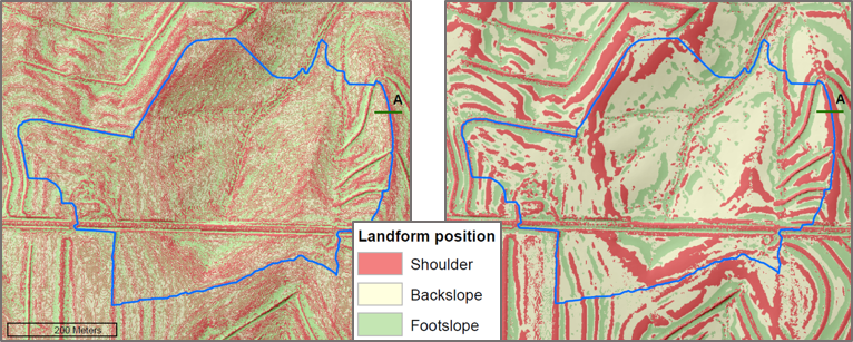

James et al., 2014 computed profile curvature on a 1m resolution digital terrain model (DTM) of Iowa and reclassified it into 3 landform types. On the left is the 1 meter DTM using a traditional 3 x 3 neighborhood, on the right is the result from an adaptive neighborhood range from 3 x 3 to 15 x 15.James et al., 2014 computed profile curvature on a 1m resolution digital terrain model (DTM) of Iowa and reclassified it into 3 landform types. On the left is the 1 meter DTM using a traditional 3 x 3 neighborhood, on the right is the result from an adaptive neighborhood range from 3 x 3 to 15 x 15.

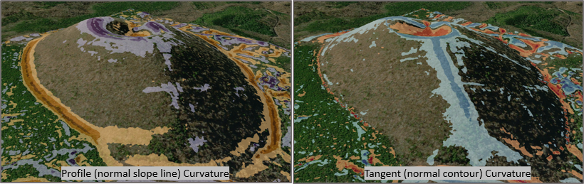

Profile (normal slope line) curvature on the left and Tangential (normal contour) curvature on the right, computed on a 5 meter resolution DSM with 15x15 or (75) meter adaptive neighborhood and quadratic surface fit.Profile (normal slope line) curvature on the left and Tangential (normal contour) curvature on the right, computed on a 5 meter resolution DSM with 15x15 or (75) meter adaptive neighborhood and quadratic surface fit.
Notice the high convex profile curvature in purple (erosion) around the rim of the crater, and high concave profile curvature in orange (erosion) around the base of the cone. On the right notice areas of high concave tangential curvature in red (convergence) inside the crater, and high convex tangential curvature in blue (divergence) on the ridge facing you. Areas with small curvature values are transparent to improve interpretation.
