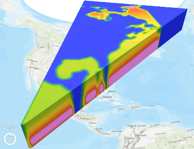

Beyond the time dimension, the Space Time Kernel Density tool allows the integration of elevation data in kernel density estimation. Through this integration, you can analyze any phenomena that vary with depth or height. The tool uses a search radius in the elevation dimension and an elevation interval to enable analysis with elevation data. Similar to the temporal counterpart, the Search Radius (z) (kernel_search_radius_z in ArcPy) parameter allows the user to define a range for analysis in the vertical dimension. This means that the tool examines the data in discrete elevation bands and enables the identification of sharp gradients or subtle shifts in conditions. The Elevation Interval (elevation_interval in ArcPy) parameter defines the size or thickness of each vertical segment included in the analysis. By breaking the vertical dimension into consistent slices based on the set interval, the tool allows you to detect small changes or trends at different heights without the analysis becoming too noisy or too detailed.
This example uses the Global Navy Coastal Ocean Model (Global NCOM) data to explore how temperature varies with depth. The data was analyzed in 10-meter elevation intervals with a 75-kilometer search radius in the (x,y) dimension. This helps to identify changes in temperature at different depths and shows how the water layers are arranged.
Space Time Kernel Density of temperature data at different depths, seen as a voxel layer in a Local Scene (vertical exaggeration was used for visualization purposes)Space Time Kernel Density of temperature data at different depths, seen as a voxel layer in a Local Scene (vertical exaggeration was used for visualization purposes)

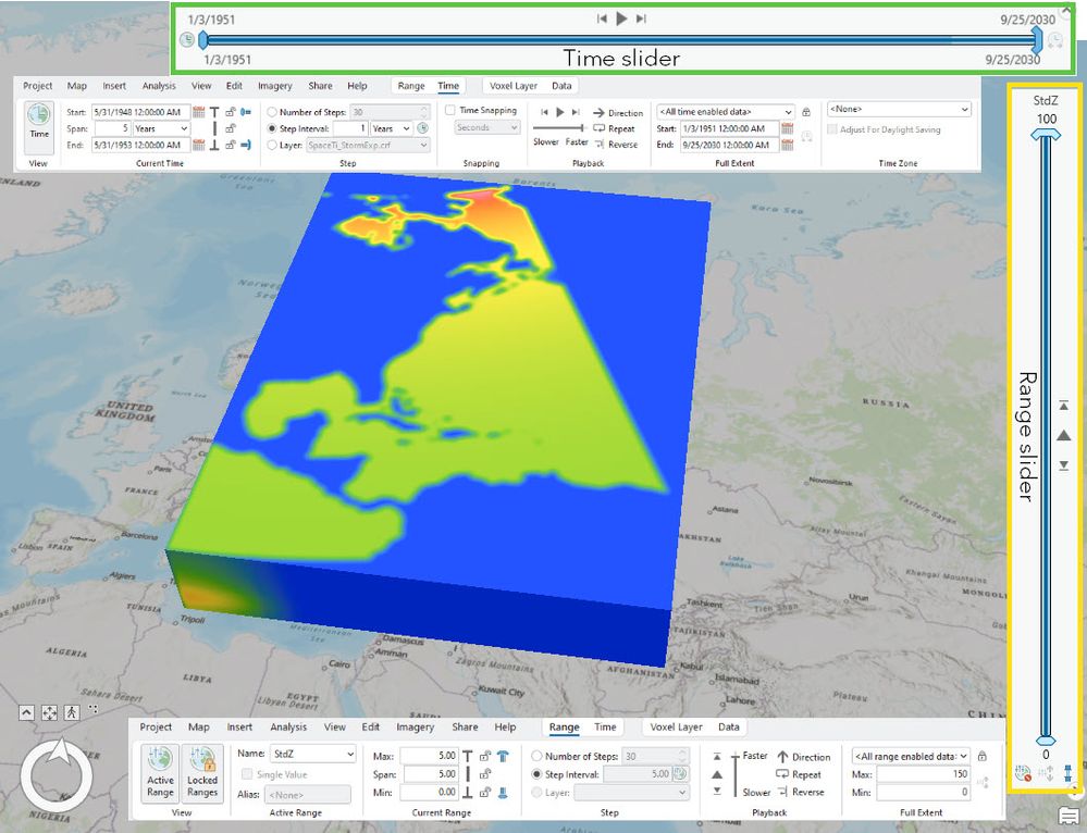

In ocean observations, data is often collected over a specified time across elevation. To understand the density trends at different heights (or depths) over time, it is recommended that you run the Space Time Kernel Density tool with both time and elevation dimensions. Since the output density raster will include time and elevation dimensions, you can use the time and range sliders on display to edit or change visualization. The Range and Time tabs will also be available to customize the output multidimensional density raster.
Example output voxel layer from the Space Time Kernel Density tool- time and range tabs are added for reference (vertical exaggeration was used for visualization purposes)Example output voxel layer from the Space Time Kernel Density tool- time and range tabs are added for reference (vertical exaggeration was used for visualization purposes)

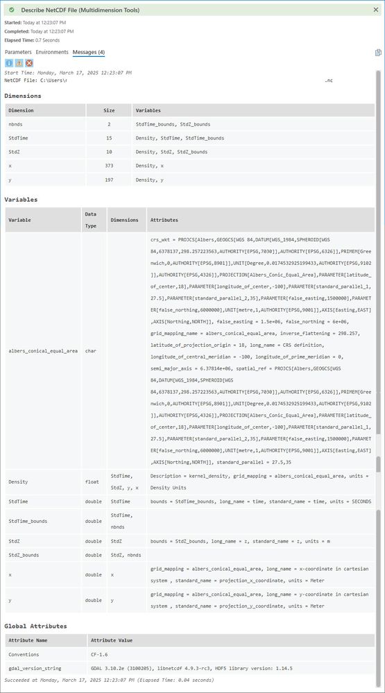

If you run the tool with a voxel layer output or only NetCDF output raster type, there will be no contents added to the Contents pane except when you are on a local scene. There will be a notification stating this. You can use the output NetCDF raster to visualize it in a local scene or use other tools available in ArcGIS Pro such as Describe NetCDF File to understand the output NetCDF raster.
Output from Describe NetCDF tool generated using the NetCDF file by the Space Time Kernel Density toolOutput from Describe NetCDF tool generated using the NetCDF file by the Space Time Kernel Density tool

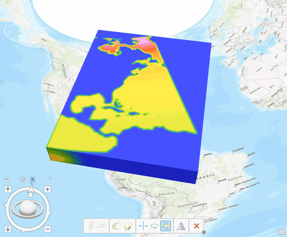

If the Space Time Kernel Density tool is run in a local scene, the tool will create and add a voxel layer to the Contents pane by default. If you only create a NetCDF raster output without creating the voxel layer, you can use the NetCDF raster to add the voxel layer to a local scene using the Add Multidimensional Voxel layer dialog box.
Voxel layer output from Space Time Kernel Density tool (vertical exaggeration was used for visualization purposes)Voxel layer output from Space Time Kernel Density tool (vertical exaggeration was used for visualization purposes)
