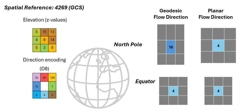

To understand the impact, consider a 3 x 3 grid of elevation cells. Consider the example shown in Figure 1
At the equator, the cells are consistent in size and shape, so the distances between cell centers are roughly equal in all directions. In that case, whether you use a planar or geodesic method to calculate distance, the result is essentially the same. Flow direction is unaffected.
Now move that same grid to near the North Pole. Here, the cells are distorted; they’re narrower in the east-west direction than in the north-south direction. Distances between cell centers are no longer equal. A planar calculation doesn’t account for that distortion, but a geodesic one does. The result: what would have been a southward flow direction at the equator may now correctly resolve as westward flow at the pole when calculated geodesically.
Figure 1. Side-by-side grid diagrams showing consistent cell sizes at the equator vs. distorted cells near the pole, with flow direction arrows illustrating the difference. Note: The North Pole grid has been exaggerated for visual purposes.​Figure 1. Side-by-side grid diagrams showing consistent cell sizes at the equator vs. distorted cells near the pole, with flow direction arrows illustrating the difference. Note: The North Pole grid has been exaggerated for visual purposes.​
For a single cell, the difference might seem small, but hydrologic analysis involves thousands or millions of them. At large or global scales, those small per-cell differences  accumulate into meaningful errors in stream networks and watershed boundaries.

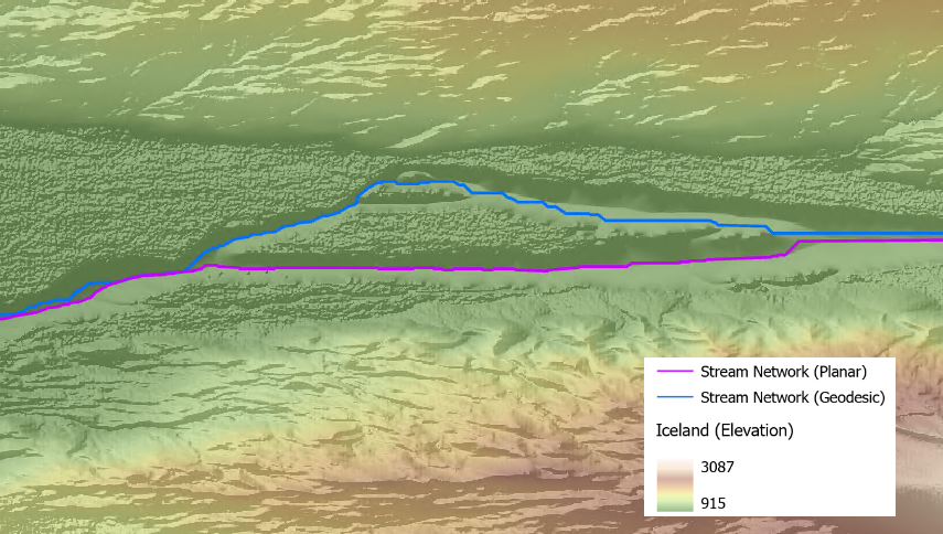

To see the impact clearly, consider a full-extent analysis of northern Iceland. When we compare stream networks derived from planar flow direction (shown in purple) versus geodesic flow direction (shown in blue), the differences are visible across the entire dataset, from where streams originate to the paths, they follow across the landscape. Every one of those differences traces back to how flow direction was calculated.
Figure 2. Iceland stream network comparison — planar (purple) vs. geodesic (blue) streams.Figure 2. Iceland stream network comparison — planar (purple) vs. geodesic (blue) streams.
If your analysis uses diverse data with different coordinate systems, spans continents or large-scales or you just want to keep your analysis in geographic coordinate system (GCS)use the new Geodesic Flow Direction tool to ensure the flow direction raster output accounts for the Earth’s curved shape.
