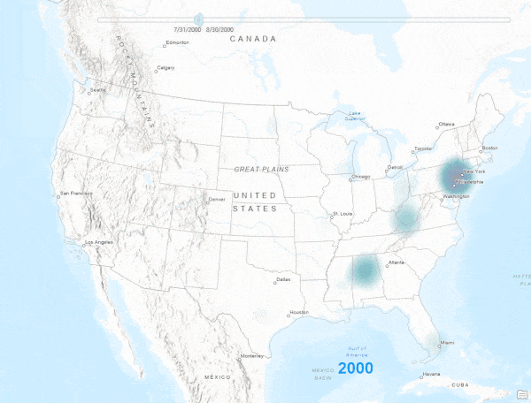

We ran the Space Time Kernel Density tool to transform discrete storm events points with damage information into smooth, monthly time slices of damage intensity. For each hazard type, we adjust the search time window—such as 5 years for floods, 12 months for heat waves, or 60 months for hurricanes—to reflect event seasonality. A cell size of 20 kilometers and a search radius of 250 kilometers were used to create a balance between spatial resolution and computational efficiency. The output is a multidimensional raster in which each slice depicts weighted damage intensity over the chosen window at a monthly interval.
Property damage density from flood events between 2000 and 2020Property damage density from flood events between 2000 and 2020

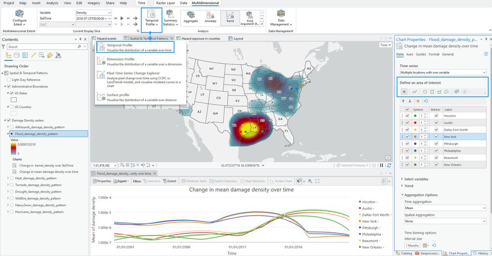

While traditional kernel density rasters reveal hot spots where damage from storm events cluster, the multidimensional output density rasters from Space Time Kernel Density provide much more insight. By browsing through the Multidimensional Analysis pane from the STKD output, you can observe how hot spot locations shift over time, including capturing drought cycles, snow-season peaks, or hurricane-landfall patterns. These visual cues guide deeper investigation and help validate the subsequent zonal summaries.
Exploring temporal properties using the Multidimensional Analysis context tabExploring temporal properties using the Multidimensional Analysis context tab

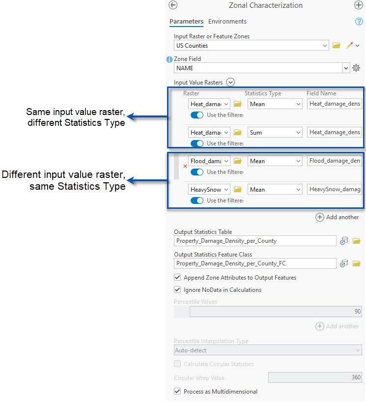

Next, we ran the Zonal Characterization tool to sum density values within each county boundary for every time slice. This produces an output table of summed density values, and an optional feature class with the same attributes for each county. The advantage of the Zonal Characterization tool is that it allows us to calculate more than one statistical property for a value raster and we can include more than one value raster in one operation. Most importantly, the tool can calculate statistics for input raster if they are multidimensional. Therefore, the output multidimensional density rasters from the Space Time Kernel Density tool can be directly used here and we can calculate the mean, minimum, and maximum damage density per county across each time slice for each county.
Understanding zonal characterization with multiple value raster and different Statistics TypeUnderstanding zonal characterization with multiple value raster and different Statistics TypeBecause the Space Time Kernel Density outputs are normalized by area and time, to recover the U.S. dollars damage totals per county, we need to multiply each county’s summed density by the cell area and the time-window length.

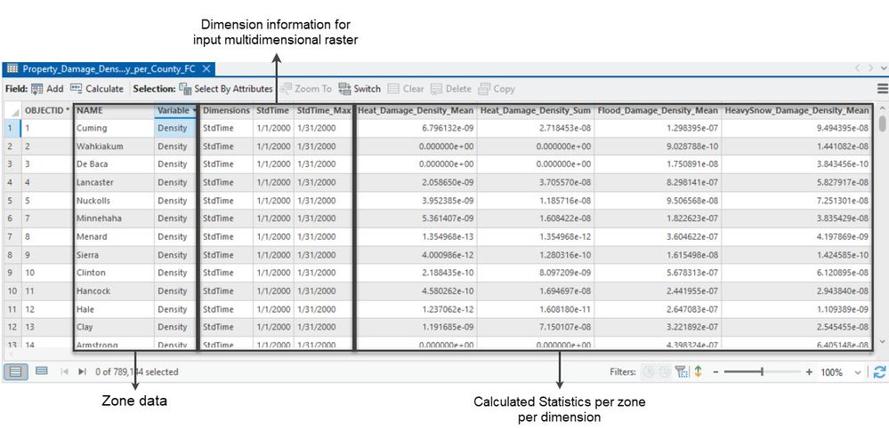

Understanding Zonal Characterization output attribute tableUnderstanding Zonal Characterization output attribute table
