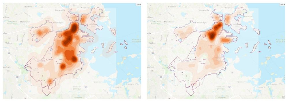

The Point Density tool will calculate the density of point features around each output raster cell. It assumes uniform weights for each point irrespective of the distances between the two points. Conceptually, a neighborhood is defined around each raster cell center, and the number of points that fall within the neighborhood is totaled and divided by the area of the neighborhood. The point density output rasters for the reported crime incidents and 311 calls indicate a prevailing cluster around the downtown area. While the crime incidents density map also has other clusters, for the 311 calls map, the region between South End and Downtown appears to be the hotspot. However, since the Point Density tool only considers the incidents within the unit area, the distance between individual incidents does not have any effect on the output raster.
PointDensityFigure
Density map of crime incidents (left) and 311 calls (right) in Boston using the Point Density tool

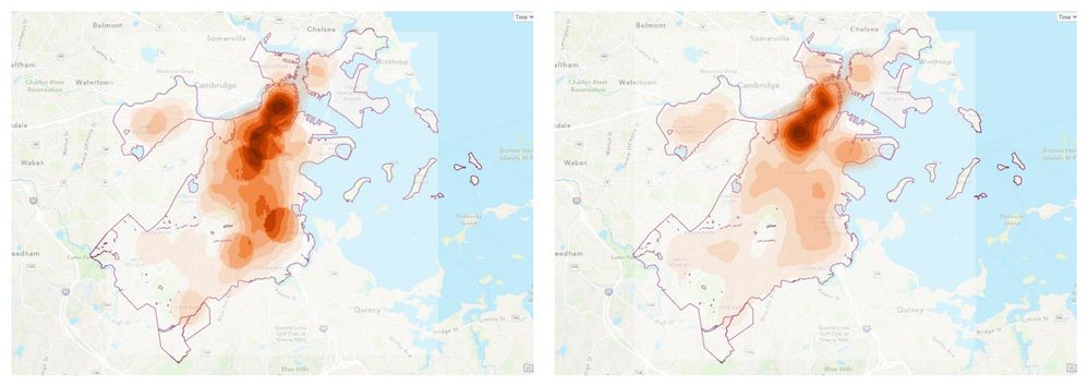

To consider the effects of distance between the incident locations on the density calculation, you can use the Kernel Density tool.
By considering the (weighted or unweighted) distance between incidents, the Kernel Density tool provides a different insight into the clustering of the incidents compared to the traditional Point Density tool. This is because there is a difference between how the two density tools calculate density and consider the radius around the incident points.
In contrast to the Point Density tool, the Kernel Density tool calculates a magnitude-per-unit area from point or polyline features using a kernel function to fit a smoothly tapered surface to each point or polyline. Conceptually, a smoothly curved surface is fitted over each point. The surface value is highest at the location of the point and diminishes with increasing distance from the point, reaching zero at the Search radius distance from the point. While the Point Density tool supports four types of neighborhoods (Rectangle, Circle, Annulus, Wedge), the Kernel Density tool only supports a circular neighborhood. Although both the outputs display the concentration of points in some areas, the output raster created by the Kernel Density tool is smooth due to the use of the kernel function. The Point Density tool is more useful for equally contributed occurrences in which the distance between two points is not weighted (such as Facility locations and counts).
KernelDensity_Figure
Density map of crime incidents (left) and 311 calls (right) in Boston using the Kernel Density tool

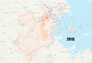

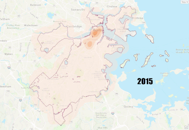

While the output from both these tools offers insight into the spatial distribution and clustering of the incidents, any insights into the distribution of these occurrences over time is still missing. You can split the temporal data and run the tools for individual years and use those for the information; however, that is not always the most efficient approach or solution. The Space Time Kernel Density tool allows you to calculate density considering both time and elevation. In this case, to understand the density of crime incidents in Boston over time, you can employ the Space Time Kernel Density tool to understand the spatial distribution of the incidents while also gaining insights into their temporal distribution and clustering patterns. The output from the Space Time Kernel Density tool is a multidimensional raster, either in Esri’s Cloud Raster Format (.crf) or as a NetCDF (.nc) file. It will contain slices based on the defined intervals.
This example used a one-year time interval to understand the yearly distribution between June 2015 and June 2023. Therefore, the output CRF raster has eight dimensional slices. If you use the Aggregate Multidimensional Raster tool to create an aggregated density raster for all the slices together, it will give you an idea of the overall distribution. The advantage of using the Space Time Kernel Density tool is that it offers to define the search radius in all dimensions (x, y, z, or t).
STKD_Crimes_gif STKD_311_gif
Density map of crime incidents (left) and 311 calls (right) in Boston using the Space Time Kernel Density tool

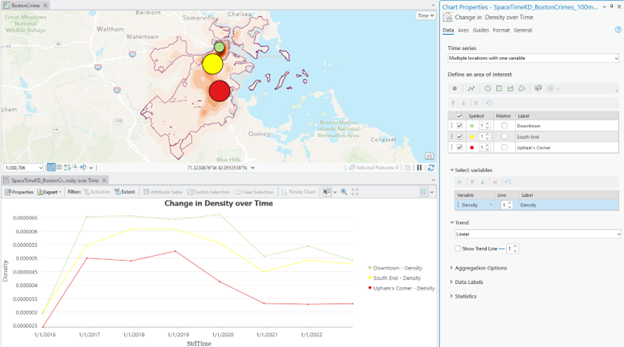

The Space Time Kernel Density tool allows you to use other multidimensional tools to better understand the density distribution. For example, with the density raster calculated using the Space Time Kernel Density tool, you can identify the temporal trends using the Predict Using Trend Raster tool or create a Dimension profile chart to understand the distribution of the multidimensional variable over time.
 Use of Dimension Profile options to create a temporal distribution of Crime incidents in Boston
