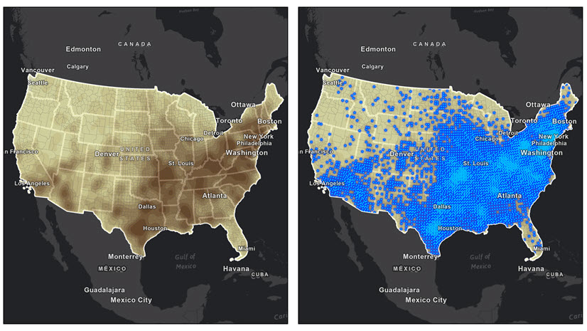

The new Raster to Weighted Points tool in ArcGIS Pro is built to address this concern. It converts a continuous raster into a representative point feature class in which point density mirrors surface intensity by preserving the spatial pattern and overall magnitude of the source surface, while producing vector features that slot directly into modeling, enrichment, and operational zone-design workflows.
A flash flood property-damage density surface (left) and the weighted points generated from it (right). Point concentration mirrors damage intensityA flash flood property-damage density surface (left) and the weighted points generated from it (right). Point concentration mirrors damage intensity

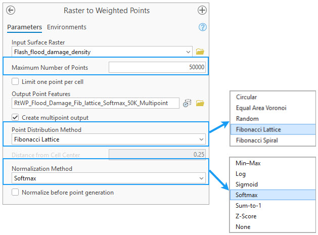

  • In the Raster to Weighted Points tool, set the damage-density raster for Input Surface Raster.
  • Set a Maximum Number of Points value (this example uses 50,000) to direct the tool to distribute the points across the study area in proportion to surface intensity.
    Damage hotspots along low-lying corridors and drainage outlets attract more points; ridges, uplands, and areas with little or no recorded loss receive correspondingly few.
The Raster to Weighted Points geoprocessing pane. Three parameters are used in this workflow: Maximum Number of Points, Point Distribution Method, and Normalization Method.The Raster to Weighted Points geoprocessing pane. Three parameters are used in this workflow: Maximum Number of Points, Point Distribution Method, and Normalization Method.

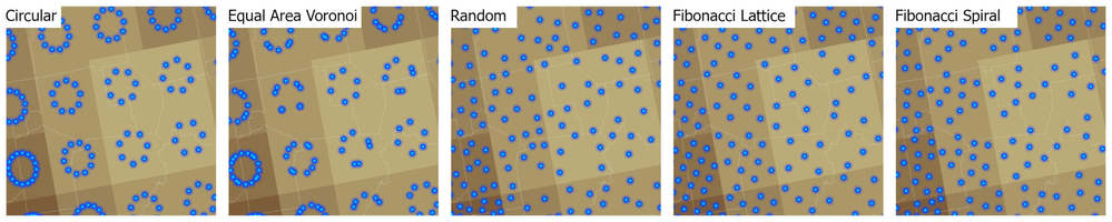

Because the downstream goal for this example is training a flood-damage regression model and running spatial cross-validation, the Point Distribution Method parameter is set to Fibonacci Lattice. The lattice produces a low-discrepancy, quasi-regular pattern of points within each cell. This distribution minimizes the within-cell clustering artifacts that can bias folded cross-validation and inflate spatial autocorrelation in residuals.
Other distribution methods exist for different analytical purposes. For example, Random is applicable for Monte Carlo workflows, Equal Area Voronoi for uniform representation, and Circular for cartographic clarity. Each produces a visibly different within-cell geometry. See Raster to Weighted Points cfor more details on when each applies.
Within-cell geometry varies sharply across point distribution methods.Within-cell geometry varies sharply across point distribution methods.

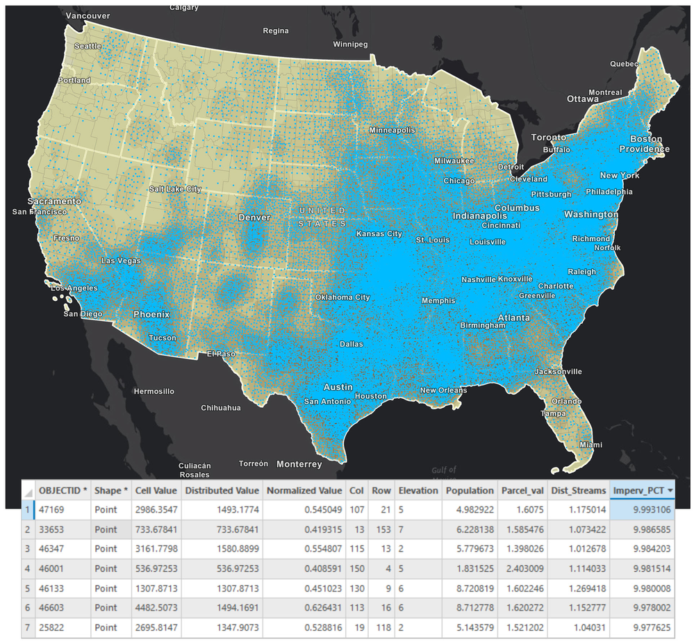

The output point layer carries the original cell value, the distributed value if more than one point is generated within one cell, and its normalized counterpart as attributes. These points are ready to be joined with context.
  • Use the Extract Multi Values to Points tool to sample elevation, distance to nearest stream, impervious surface percentage, soil hydrologic group, parcel value density, and any other predictor raster at each point location.
The result is a feature class with an attribute table of observations with a target variable and a set of covariates, grounded in the spatial pattern of the original surface.
  • Once the attributes are added to the point feature, use the enriched point features in forest-based classification and regression, geographically weighted regression, clustering, and cross-validation.
The points behave like a properly weighted sample of the underlying damage field rather than a raw incident cloud.
Each weighted point carries the original density value, a normalized value based on the selected Normalization Method option, and covariates sampled from the predictor rasters from the Extract Multi Values to Points tool.Each weighted point carries the original density value, a normalized value based on the selected Normalization Method option, and covariates sampled from the predictor rasters from the Extract Multi Values to Points tool.

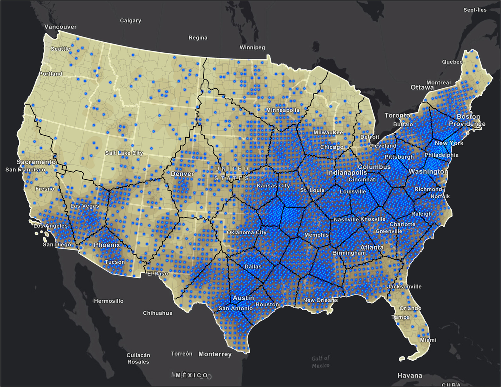

Because point density tracks intensity, the same output doubles as the input to a zone-design workflow. Paired with the Generate Subset Polygons tool, the study area can be carved into polygons that each contain an approximately equal number of points. This means, by construction, an approximately equal share of modeled damage intensity. That is how post-event damage-assessment strata, emergency response and early-warning zones, insurance rating areas, or field-inspection routes are designed when the goal is a balanced workload and equitable coverage rather than equal area.
Operational zones produced by passing the weighted points to Generate Subset Polygons. Each polygon contains an approximately equal number of points (n = 1000), translating to roughly equivalent modeled damage intensity per zone.Operational zones produced by passing the weighted points to Generate Subset Polygons. Each polygon contains an approximately equal number of points (n = 1000), translating to roughly equivalent modeled damage intensity per zone.
