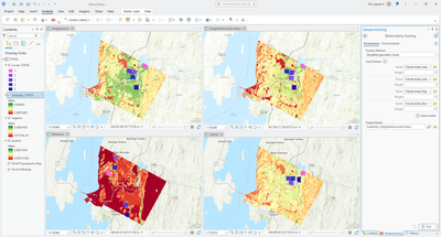

The choice of Overlay Method can significantly influence which locations are identified as most suitable. You can compare the outputs visually or analytically to distinguish differences among the methods, particularly exploring the spatial distribution of the highly suitable areas with the less suitable areas. To further analyze and quantify these differences, run the Multicriteria Overlay tool with multiple methods, followed by applying the Locate Regions to each output. This will provide you with a powerful way to reveal how candidate sites change under different overlay assumptions.
In a winery site selection example, the Multicriteria Overlay tool was run for four scenarios varying the methods but using the same criteria and relative importance weights. The methods used were Weighted sum, Weighted geometric mean, Minimum, and Ideal point solution. The Locate Regions tool was then applied to each output.
Regions shared across all four outputs indicate stable, high suitability sites that are not affected by the choice of overlay method, while regions unique to one or two outputs highlight areas where the results depend on how trade-offs are handled. Comparing the four sets of candidate sites revealed how each method's assumptions influenced site selection, helping you choose the most appropriate approach for the study.
Caption: Comparing suitability and Locate Regions outputs across multiple overlay methods using the Multicriteria Overlay tool in ArcGIS Pro
