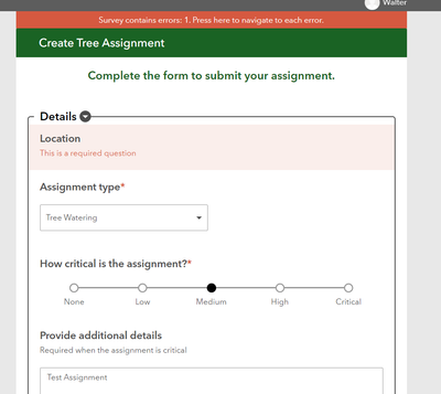

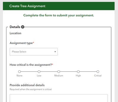

Problem with the Survey Form used to create an assignment.  The form fails to allow for the collection of an address or allow for any manual field entry.  The form does not work from within the Tree Management Center App or the Survey123 App.

The Tree Request Internal Form works as you describe by either manually entering an address or using the locator map to select a location.  But I see no selection option on the Create Tree Assignment Form.  I have tried this in the mobile app also and have the same issue.
MikeDagle
Thanks, Walter. The Create Tree Assignment form is expecting the the Location question to be answered by the Tree feature's fulladdr (Nearest Address) field. That value is passed to the form when its accessed through the Tree Management Center. It's a read only question question on the form because, as configured, that value is passed from the Tree. The form isn't configured to be accessed using the Survey123 app but rather in the browser.
