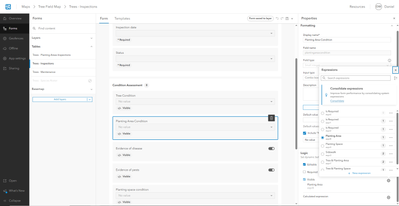

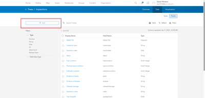

Instead, I would add fields to the existing Inspections table in ArcGIS Online (Data tab > Fields > Add +) for the planting area inspection criteria. You can then modify the Tree Field Map inspection form in Field Maps Designer to add the new fields to the form, and set conditional visibility on them based on selecting the Inspection Type = Planting Area. There's already an arcade expression to set conditional visibility on fields specific to a planting area inspection that you can use.
