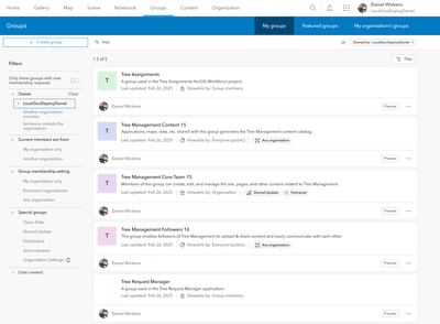

Also, you mentioned you deleted the items, but did you also make sure to delete the groups associated with the solution? There are 5 groups created when you deploy Tree Management. If those are still hanging around, those can also cause issues with deploying the solution again.

2) Are there any remaining Tree Management items still in your content? Can you check for any Tree Management related groups still leftover?

It was the groups , I had not deleted these. I have now and the solution deployed.
