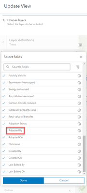

I was comparing the 'Trees' feature service with 'Trees_public' service after I deployed the solution.  If I am not mistaken, the _public service does not have a field called "adoptedby."  Just curious as to why.
DanielWickens
The 'adoptedby' field is used to store the username of the person adopting a tree in the Adopt-a-Tree solution. It's visible in the main 'Trees' feature service to view internally who has adopted which trees, but it's hidden in the 'Trees_public' view so as not to expose the username in public apps. If you wanted to make use of that field in the 'Trees_public' service, you would just need to update the feature layer view from the Settings tab. Keep in mind, this field is only relevant when using the Adopt-a-Tree solution. It's not leveraged in any components of the Tree Management solution.
JayHodny
Ah make sense Daniel, many thanks.
