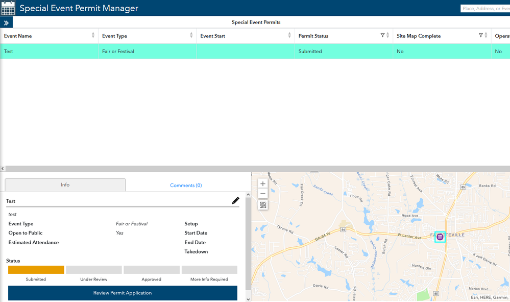

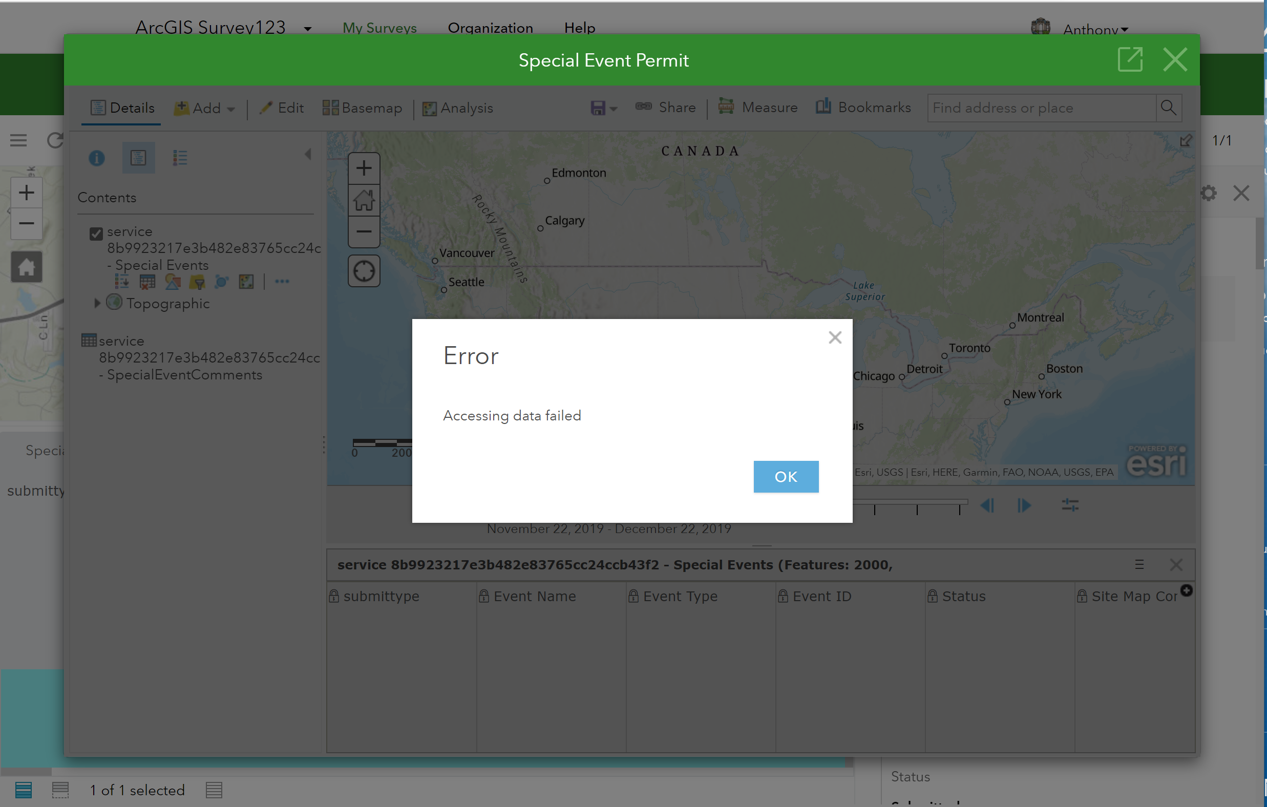

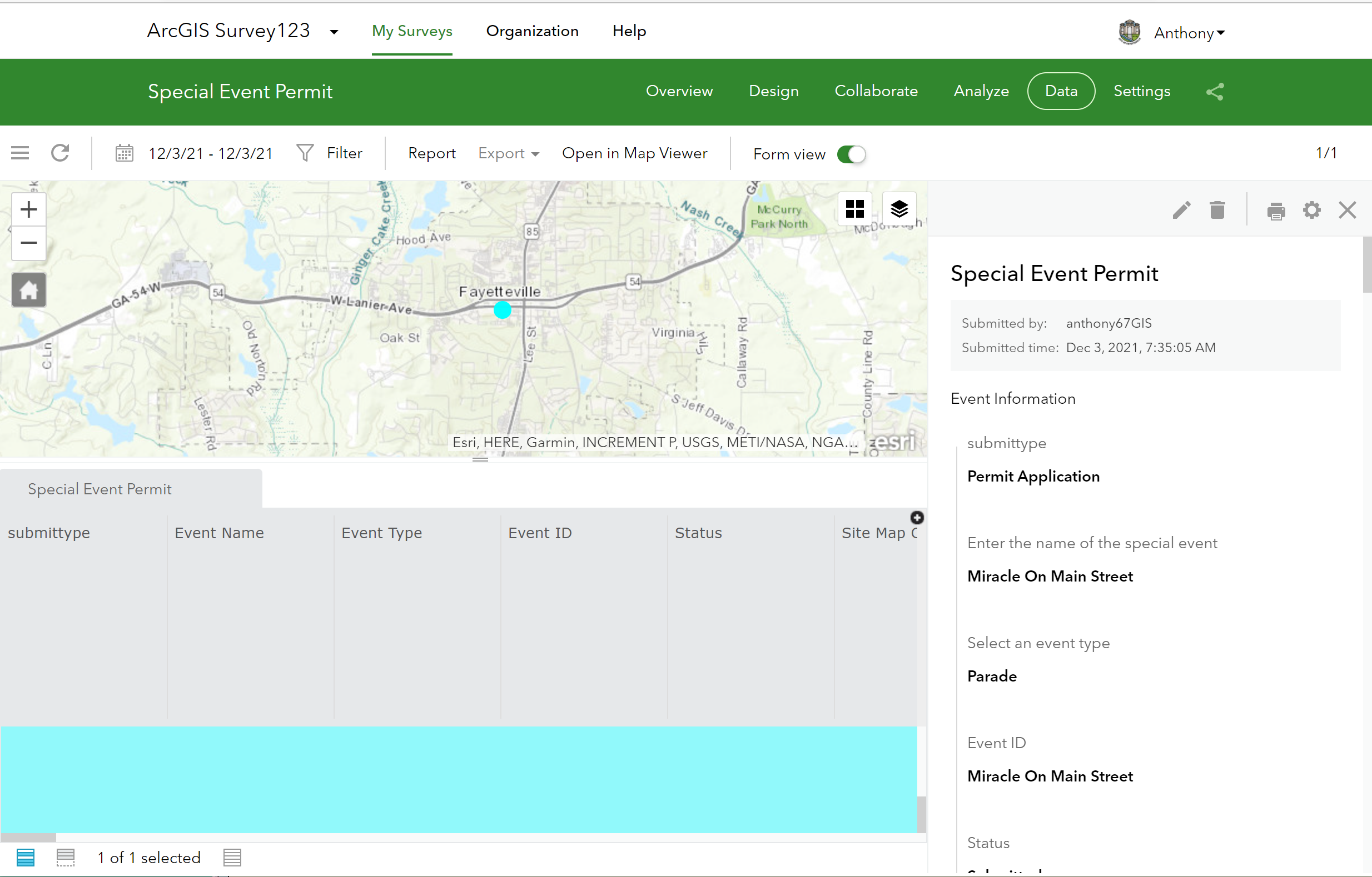

Thanks for the reply; you are correct I can't see in any Special Events map or web application. I can see that data in Survey123 but trying to open in Map Viewer (within Survey) or ArcGIS Online, no data shows up. I'll be having a closer look at your suggestion later this evening as this is got me stumped.

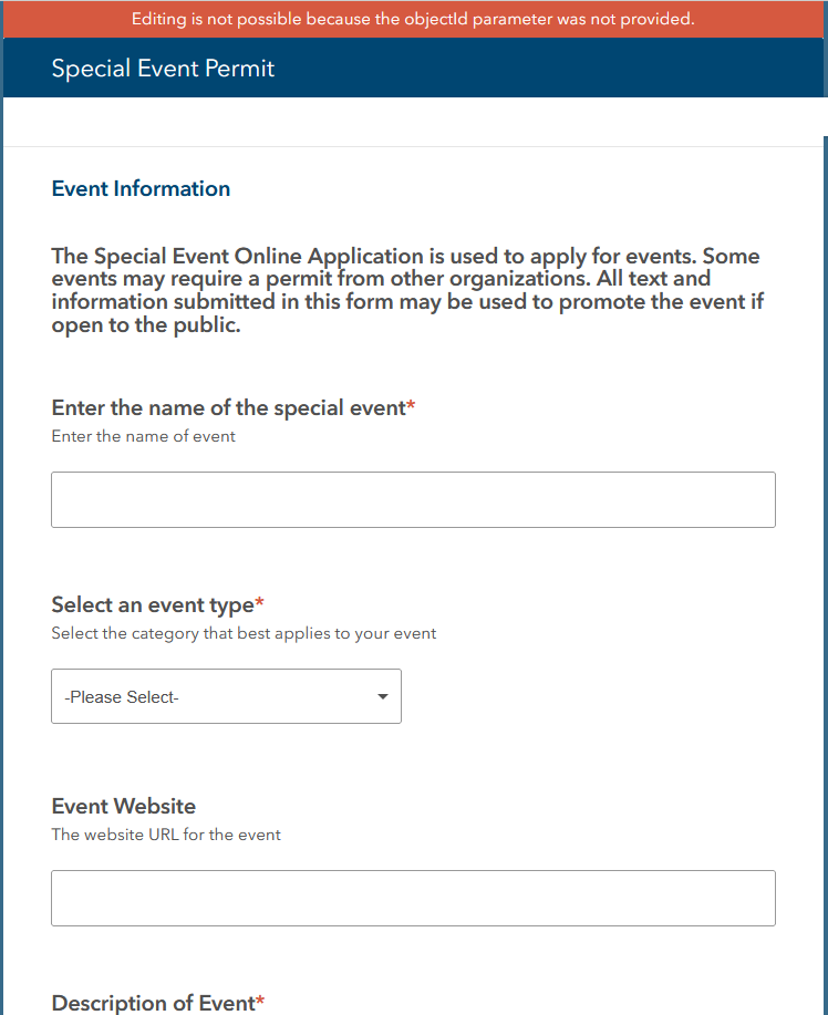

Still no solution on this and am looking for anymore insight that can be provided. The consistent error so far is "Editing is not possible because the objectId parameter was not provided."
However, looking at the data shows the objectId is in fact populating whenever an event is added.
