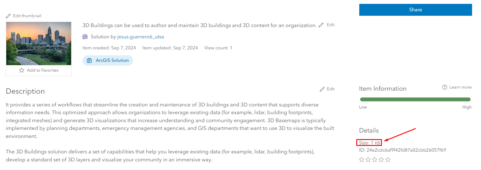

Hi. In our organization we are trying to use solutions such as 3D buildings, Trees, and other solutions. However when we deploy them from the ArcGIS Online Solutions app we only get 1KB from the solution and its not available like shown in the blog post associated with it.
Are there ways to fix this issue?

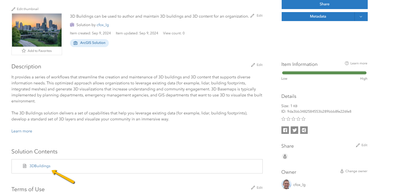

@JesusGuerrero, when you deploy a solution you will get a Solution item and one or more other items and groups with the solution. The solution item itself is pretty small. However, for example with the 3D Buildings solution all Desktop Application Template item is also deployed. This is the zip file containing the pro project you can use from the 3D buildings solution. Other solutions follow this pattern as well, see the Solution Contents section for the list of items deployed with the solution.
