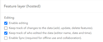

@StephenKing3 - Did you happen to change any of the editing settings for the GIS_Activities feature layer? The 'Submitted On' (created_date) field is an AGOL system field for editor tracking. If editor tracking was disabled, this could be a reason for the submission dates not coming through.

@DanielWickens, that was what was wrong. Thanks for your help again!
