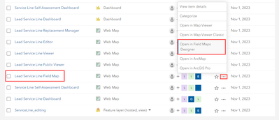

This can be done by updating the edit templates for the Lead Service Line Field Map in Field Maps Designer.
  1. In the Lead Service Line Invetory folder, click the ellipses for Lead Service Line Field Map and select Open in Field Map Designer
