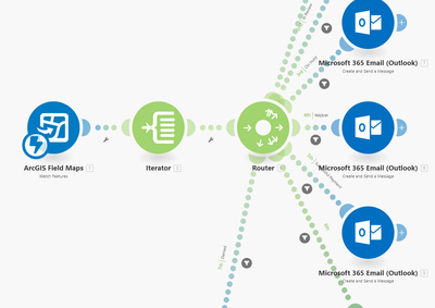

So What are your Make settings?  I would think you have to get that working before the email will work?  Can you upload a screenshot of your scenario?  I found that mine didn't work until I added an Iterator because it changed the messages incoming from the Field Maps widget into packages that other modules could receive.
Could you also paste your webhook settings?  Have you had Make successful receive messages on that particular webhook before?
You could also use the Make module to set up the emails if the JSON is giving you grief.
