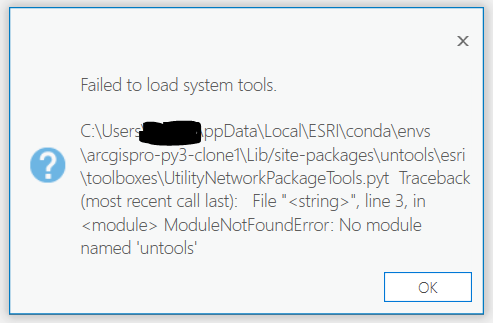

Installed Pro 2.8.1 on a clean machine (so, no upgrade). I cloned the Python Env, and closed Pro.
Installed the untools via Python command: conda install -c esri untools
When starting a new Pro project, I get this error:
after click OK, no geoprocessing toolboxes appear anymore.
Anybody got the same issue and knows how to resolve this?

Were you following these instructions?
Install the Utility Network Package Tools toolbox—Get Started | ArcGIS Solutions

I am now wondering if you had the base environment active when you installed untools rather than the clone

Did you ever find a resolution to this? I am running into the same thing. I have tried multiple cloned environments and machines, it just always fails with this error and then reverts back to the base python environment.

can't find the thread, but rolling back to 2.8.0 resolved someone's issue
