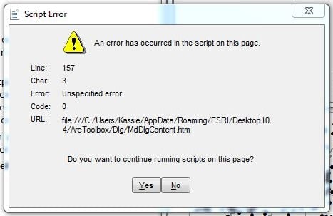

Hello,
I am trying to use the 'Create fishnet' tool on ArcGIS for Desktop in ArcMap 10.4. The following image pops up. Does anyone know how to fix this or work around it? Thanks in advance for the help/ideas!
Edit: In case it helps/makes a difference, I have it running on Windows 7 Professional.
Picture of Script Error

Try the instructions and zip file in this link.....

Thank you for trying, but it didn't work. I am still getting the exact same error message.

Try Repairing ArcGIS Desktop installation.

It worked! Thank you so much!
