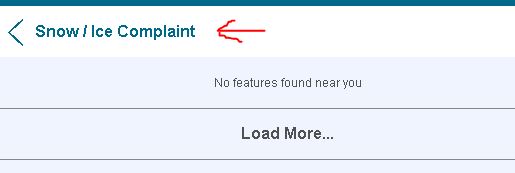

Looking to change the name/label of a layer in our CPR application. Specifically in the window that shows the existing problems. We can change the name of the class of problem, but not the title on the next screen. Picture below.

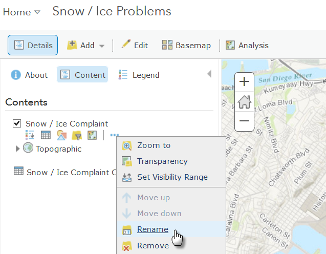

That text corresponds to the name of the layer in the TOC of the map. Update it here, and it will update in the app, as well.
-Allison
