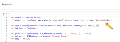

Hi @Yeaton, we didn't originally design that web map for use in Field Maps, but I don't think there is any reason you couldn't create a copy of it for use in Field Maps. Regarding the error, it looks like the Resolution arcade expression in the pop-up is causing the issue. The expression returns null when the report does not have a status of Canceled or Completed. This is so that this section doesn't display, it appears Field Maps does not like this. When I changed the expression to return the text 'No Resolution' instead of null I not longer received the error in Field Maps.
