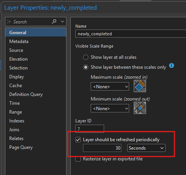

When you say "desktop app", do you mean you're using ArcGIS Pro? If so, be sure to click the refresh button JRhodes_0-1738717022956.png after making any edits in ArcGIS Online to force the layer to reload. There is also a setting in the layer properties to automatically refresh the layer:
