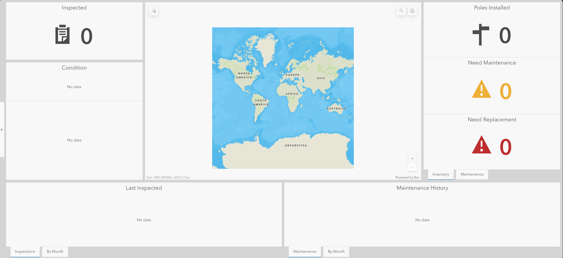

I have been able to deploy the sign manager solution and upload existing sign data using the tasks in ArcGIS Pro. However, when using the Sign Management Dashboard - Poles, it keeps messing up. The no data option shows up every time I save and refresh.

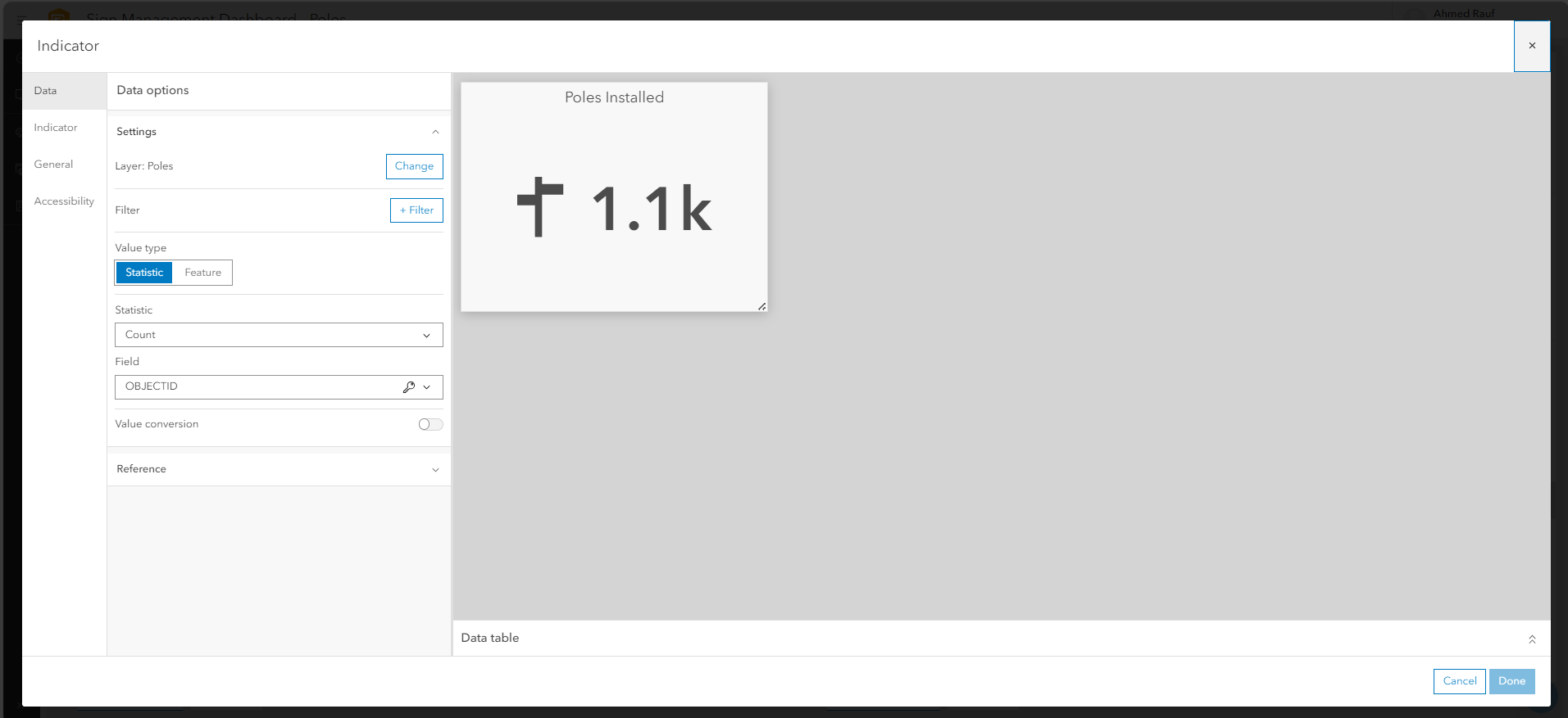

Upon configuring any element, it does show data.
It does show data, but when I refresh after saving the dashboard, it all vanishes. Any Solution?

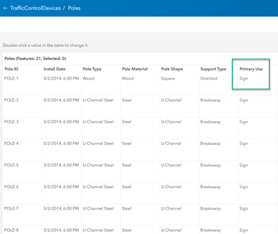

@AhmedRauf - The Poles dashboard is configured with a category selector to filter poles with Primary Use = 'Sign'. This field can be found in the Poles layer and is intended to indicate the primary use for the pole.
To resolve the issue, you can either set the Primary Use field = 'Sign' for each pole, or disable/remove the selector from the dashboard altogether.
