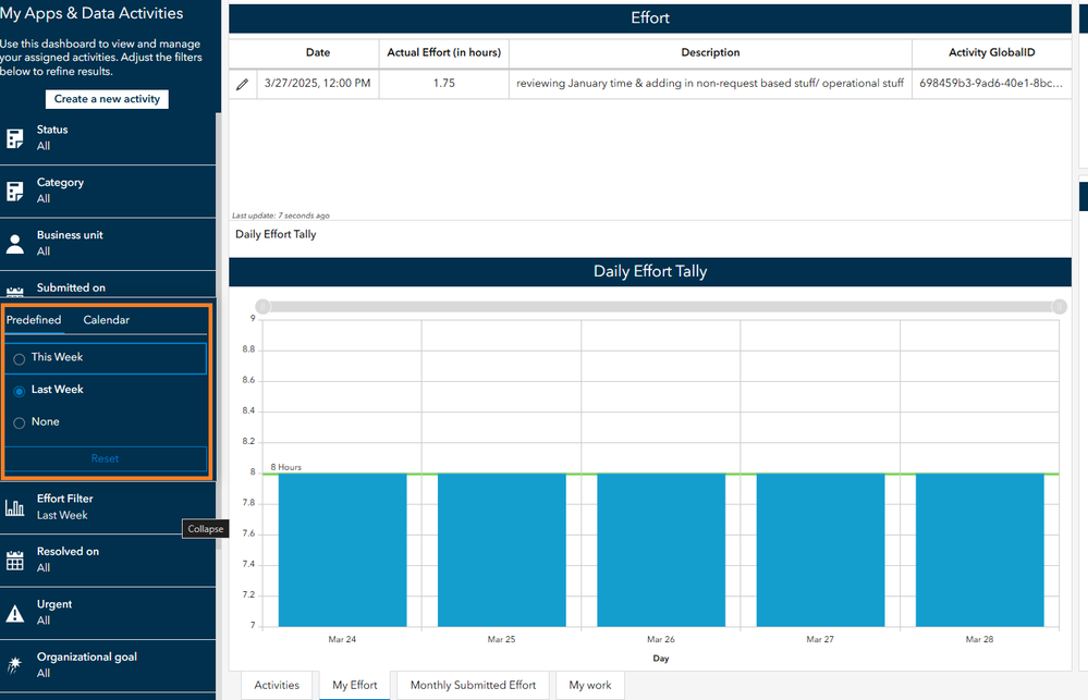

So I've attached a an image of changes that have been requested or well received by staff using this. Because we're trying to get to 8 hours per day, I added in a chart that shows a Daily Effort Tally, along with a monthly effort tally.
Selecting an activity filters & shows all effort submitted for that time period selected in our "Effort Filter"

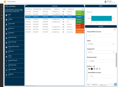

Screenshot 1: Add hours to an early task that has been completed to test/verify the display in the Effort Serial Chart item in the dashboard. Planned Effort: 2, Actual Effort: 1.25

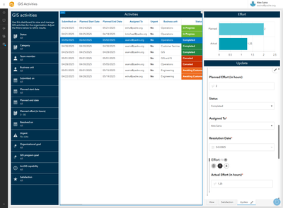

Screenshot 2: Add 0.25 hours to account for brief follow up task with the GIS team. Planned Effort: 2 (unchanged); Actual Effort: add 0.25 hours using the "+" to add an entry. Planned Effort updated to 4 hours when refreshing the dashboard. Actual Effort: 1.5 hours (first entry + second entry).
Screenshot 3: As a test, add an entry to Actual Effort (0.25 hours) and enter zero (0) in Planned Effort to avoid adding the previous values together. Result: Planned Effort changed to zero (0), Actual Effort updated to 1.75 (1.25 + 0.25 + 0.25 = sum of first three entries)

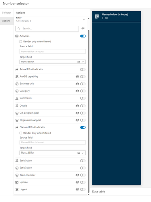

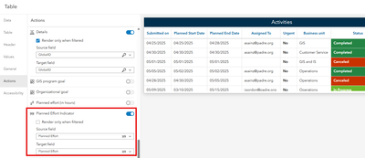

- Remove the Serial Chart with Planned Effort and Actual Effort
- Add Indicator widgets for Planned Effort and Actual Effort
- Planned Effort indicator widget: Data Source = GIS Activities effort, Statistic = Sum, Field = Planned Effort
- GIS activities table (Actions tab): Toggle ON filter for Planned Effort Indicator. I tried setting the Source Field and Target Field to GlobalID and Planned Effort - same result.
- GIS Activities Number Selector widget > Planned Effort (in hours): Source Field is Planned Effort (grayed out, cannot be updated); Target Field = Planned Effort. Same result as setting Source Field and Target Field for the Table widget.

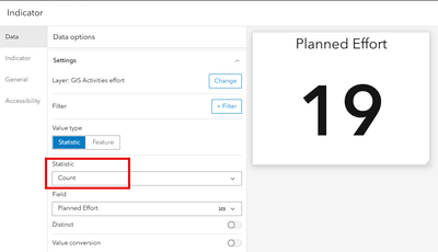

@BrandiRank22 Issue resolved. This was definitely a case of user error. As a follow up, your assistance and feedback have been greatly appreciated. Additional info provided below.
Data Source: GIS Activities effort
Field: Planned Effort
Statistic: Count (by default this is configured as Sum in the Indicator and the Serial Chart).
Screenshot 4: Planned Effort Indicator widget in GIS Activities Dashboard
