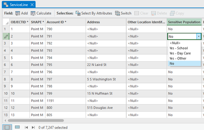

I couldn't replicate your issue. My export includes the domains and dropdown values. I took the following steps:
  1. In ArcGIS Online, I chose Export Data -> Export to FGDB for the ServiceLine feature service.
  2. I downloaded the FGDB and unzipped the zip file
  3. In ArcGIS Pro, I added the newly unzipped FGDB
  4. After expanding the FGDB, I right-clicked the ServiceLine feature class and clicked Data Design -> Fields
  5. The domains are assigned to the appropriate fields
  6. To double-check everything was correct, I opened the ServiceLine table and ensured I had a picklist of values to choose from
StaceyRoberts
Thanks @AlexKabak. I did use an enterprise geodatabase. I did find the domains, but they were not applied to the fields, so I only had to go through and add them.  An extra step, but better than building from scratch. Thanks!
