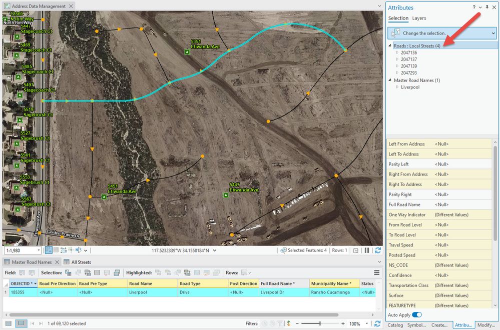

This is a suggestion in regard to editing, or more specifically, editing in the Address Data Management Solution.
Unless I am missing something, there does not appear to be a way to link multiple road segments to one record in the Master Road Names table. It has to be done one by one. As you can imagine, this can be quite time consuming when dealing with a lot of new roads.
It would be a huge time saver if you could simply right-click where the red arrow is pointing and have "Add Selected to Relationship" as an option. It could work similarly to how clicking there allows you to edit the attributes of multiple road segments.
Allowing the ability to link the selected road segments to one record in either the Master Road Names table or the Alias Road Names table would be a huge time saver when dealing with a lot of records.

@Todd_Stout, In the default solution configuration we don't have a relationship between the Master Road Names table and the Road Centerline feature class. However, if you have added this relationship yourself it is possible to accomplish what you are describing. Instead of doing this from the Roads layer, what you would do is expand the Liverpool record under the Master Road Names table. Then right-click the Roads layer and select 'Add Selected to Relationship'. This will add 4 selected road segments to the relationship.
ScottOppmann
As Chris notes, this is possible in ArcGIS Pro if the relationship has been added by a user.
