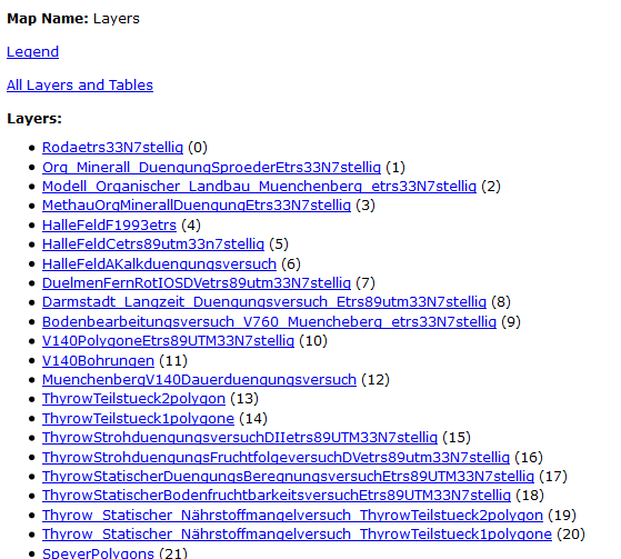

There is a default search box in ArcGIS javascript API dojo lib to search by place name or by city. Now i want to add a intelligent search box to search within the layer. I would like to know how to add such search box and implement function to search within the layer.I have a ArcGIS javascript API application where I have 30 layers and I want to search the layers accoding to name in search box and fly to that corresponding layer. Please suggest me the right way.
I have attached the image of my application with all the layers (arcgisdynamicmaplayers).

Hello Robert, thanks for your reply. I saw this example before in ArcGIS for Javascript API sandbox. My case is little different. If you see my screenshort , there are 30 layers inside one mapservice. and I want to search by the name of the layer. The example belongs to one or more featurelayer table_fields value searching option. So in my case the layer names are not in any table, so how can I make the search?

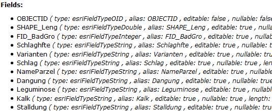

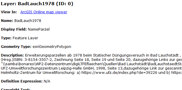

Hello, i understand the widget problem. But what should i use for the queryfield! here . I am not using a specific layer like /mapserver/0 or 1 or 2 . See the image , i am using commonly the map service. How could i use the layer name then?
RobertScheitlin__GISP
MVP Emeritus
Muqit,
  As I said it does not matter if you are using the whole map service in the map. The Search Widget requires you to add a FeatureLayer (a specific layer of the map service) that is why i mentioned that you will need to add all 30 if you really need to search all of them.

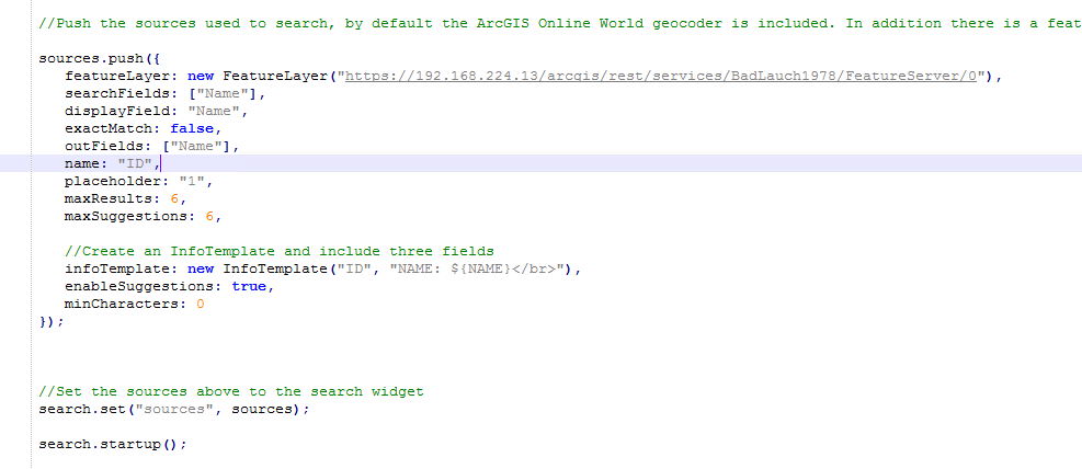

Hi, i have tried according to your details. But its not working. See my added code. Still now i have the same question how could i search using the layer name ? Becase Layer name is not a layer_table Field. I want to search (for example: BadLauch1978)
MVP Emeritus
Muqit,
  I am struggling to see why you are not getting this if you are reading the help documentation for the Search widget.
