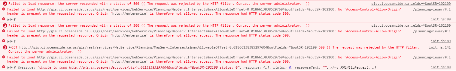

   What does your browser web console say the error is? (use F12 to open your browsers developer tools and switch to the console tab).
SeanPhayakapong2
Screenshot
Here is a screen shot. I hope this helps. Here is a link to the webpage. However, I am using the service from my County instead of the City's.Ideally I want to Search APNs using our Parcel Layer.

   That looks like an issue that you will have to take up with your IT dept.

  Actually the issue has very little to do with GIS it is just a http request filter issue.

  Your IT people should be able to look at the network traffic of the app and diagnose the issue.... Just have them take the time and look.
