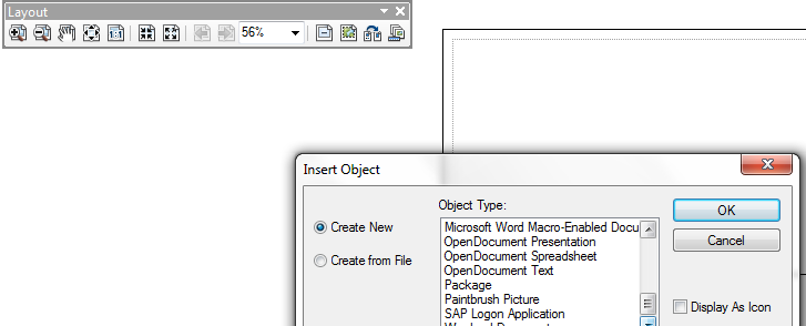

So, I am thinking about an upcoming programming challenge where something rather like a table, but requiring many of the extra things (events, full graphical drawing control) that say WPF or other .net facilities provide, is a working part of a layout. I poked around with various documentation, but don't see what I'd have to do to wrap my custom table such that it could be placed on the layout.

I have long been fascinated with, but never got into, internal worlds. This one, though, had more to do with what COM interface, or other mechanism, would you have to do in order to make your custom object (whatever its purpose) be something you could add to a layout. You may not have had to get that far into CE's primary maps, but they basically have just the feeder, with each point of control or intervention displayed on the map, with a letter designation, and a table off in whitespace the lists all the letters and operational stuff about the location. So, it's almost doable with just a Esri table that has multilines and formatting tags, but then it also has some graphics and interaction that would be relatively easy with a .net table (WPF or System.Windows.Forms, DataView etc) but not clearly doable in an Esri table...so that's why I am trying to know just what (COM Registration of some kind I guess) makes that dropdown list of supported object types on a layout...
