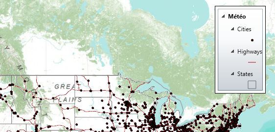

Strange. I tweaked the Legend sample in the interactiveSDK to set a French display name for the local dynamic map service layer and I didn't notice any issue:
I tested by setting the DisplayName in XAML and in C#. Both work.
