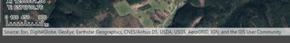

while creating a "screenshot" of the mapview with ExportImageAsync the watermarks are missing, so i tried to add them after creation.
When loading a WebMap the watermarks in the mapview are the content of the Layer-Attribution.
After some seconds the watermarks in the mapview processed in an unknown way.
Is there a way to access the prepared watermarks?
Example:
URL: https://services.arcgisonline.com/ArcGIS/rest/services/World_Imagery/MapServer
Attribution: " Source: Esri, DigitalGlobe, GeoEye, Earthstar Geographics, CNES/Airbus DS, USDA, USGS, AeroGRID, IGN, and the GIS User Community"
Original Content

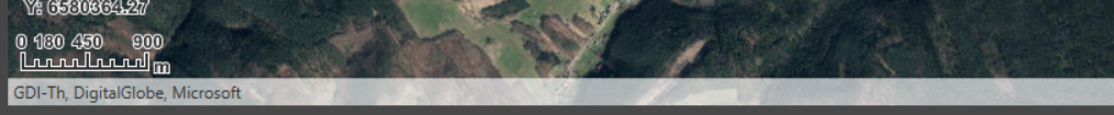

after a few seconds:
Processed Content
ChristianTügel
Already found it in MapView.AttributionText
ChristianTügel
