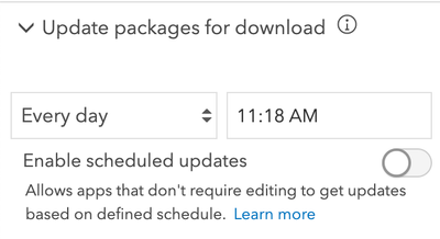

Hi Nicholas,
In your reply - "You don't set a time in the ArcGIS Online interface" - Can you clarify this. There is a setting for Time in AGOL, can you explain what this time is for?
Nicholas-Furness
Apologies. I misunderstood your question about changing the update time to trigger a scheduled updates packaging. My mistake (your question was pretty clear!). I'll have to check with the team to see if this would trigger packaging things up, or if there might be some other way (e.g. a REST call).
