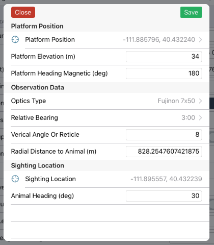

When I first display the attributes things look fine:
As you can see the "Sighting Location" attribute is displayed as valid lat/long values.

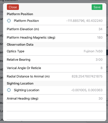

If we perform the offset calculation again (say someone edits the reticle count and re-saves the record) the attributes displayed by the same cell logic produce this result:
As you can see the values for Sighting Location are now displaying a very small number for Lat/Long based on the same attributes (feature.envelope.center).  This value appears to be the offset applied to the feature, not the actual Lat/Long of the geometry.  If I close down the view and reload (which re-selects the feature from the geodatabase) the table appears as expected, with the correct Lat/Long values.

I think maybe the point you're getting back after applying an offset does not have a spatial reference set on it. So when you go to project it you get weird values, but  when you try to save that geometry to the database, the database notices there isn't a spatial reference so it assumes it is in the native spatial reference of the data and assigns it that in the database. When next time you refetch the feature it has the correct spatial reference which projects nicely.
Boy, that was a mouthful.
Bottom line, just make sure all your geometries have the right spatial reference along each step, and see if that solves anything
