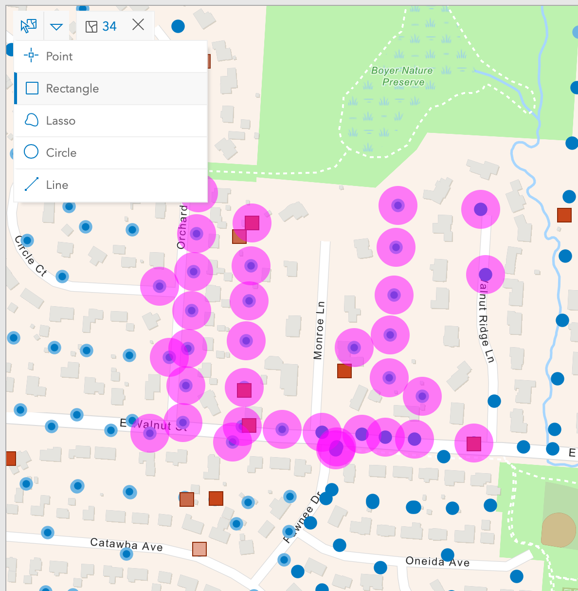

I want to achieve basic functionality as this dashboard provides. User can select features not only by point but also by rectangle, lasso, circle and line. Is there any solution or starting point for this?
Example of selection by rectangle area
example of selected features by rectangle selection
